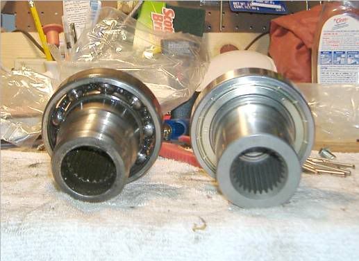

Ok, is the dana300 shaft a female shaft that slides on to the 700r4 shaft? I've never seen a dana300 out of a vehicle. The adapter that came off of the original np233 (Push Button 4wd) is only a 5 bolt pattern I've never seen one of those either, until now. Is there not enough material on the 208 adapter to re-drill the 6th hole?
I'll check out jb conversions I can pick up a 208 adapter for like $25
The 6th hole on the adapter is just a bit off, and I've never heard of anyone having any issues just running 5. I actually got my adapter from JB conversions as well as the input shaft. The guy I spoke to was familair with the 208 adapter. Of course he told me how their adapter was better, but in the end, he had some 208 adapters, and he threw one in that was inspected and media blasted for $20
I did swap to a sealed bearing on the output shaft since there is no seal between the trans and t-case. The sealed bearing keeps the fluids from mingling. I'll find the bearing part #. Here is my install thread
Here you can see the new input shaft with sealed bearing vs stock
What trans are you using?
