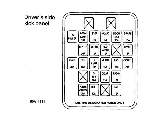

Try this:
It's to my 96.
Good luck.

Re: Which fuse is for the Fuel Pump???? [Re: 1987Raider] #817807 08/29/07 03:14 AM
Posts: 11
KyleLovesHisKia Offline
You are mistaken, there certainly is a separate fuse for the fuel pump, it is in the passenger compartment fuse box on the left hand wall of the driver's side, down by your left foot. The diagram you posted there is not for a 2000 Sportage, either. My fuel pump fuse blew there, when the wiring got smashed under the rear seat! Of course, car wouldn't run without that fuse.
