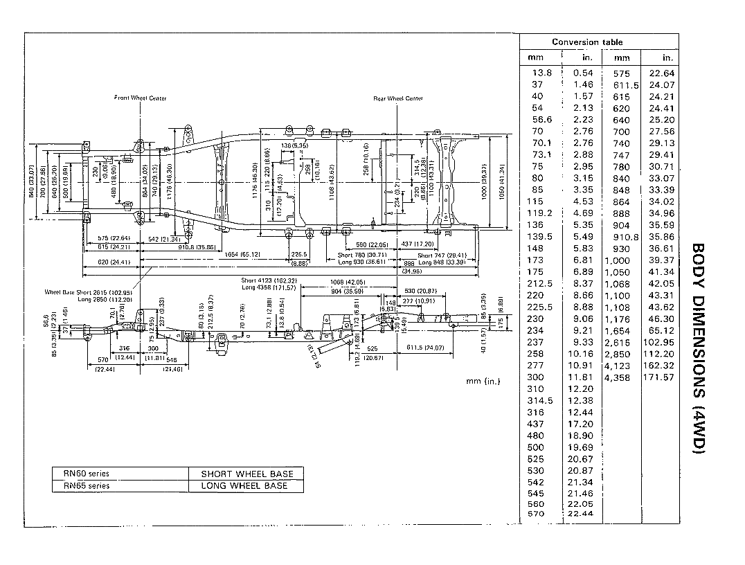

I am kicking my self for buying a reg. cab truck. Ok here is the deal I like to ride dirt bikes and when a buddy and I go riding if we take my single cab truck there will be no room for gear. So I was thinking maybe I could find a long bed and put it on my truck, then have a truck box in the bed and fit two dirt bikes in there. So my question is can you put a long bed on a short bed frame? Or how hard would it be to put an extended cab on my frame?

You can't mount a long bed; the mounts are in different spots, and yep, you'd have to extend the frame. The FSM for the '85 here should give you long/short frame dims. <img src="/forums/images/graemlins/kewl.gif" alt="" />

In addition to the bed mounts not lining up and the frame needing to be lengtheded, the wheel well would also be in the wrong place.
For the short term, you might consider building a wedge shaped box that the front tires of the bikes mount to w/the riding gear underneath.
Depending on your fabrication skills, you might consider building a flatbed designed to hold the bikes, built in storage for riding/camping gear, and a pull out ramp for loading the bikes.
