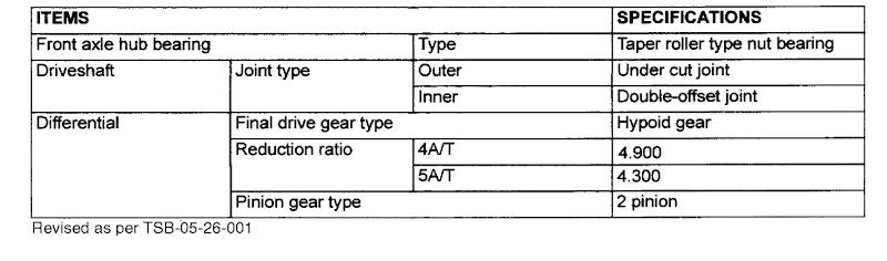

4.3 is for 5speed and 4.9 is for 4 speed. 4.9 are direct replacement for 4.3. You can get new R&P set from dealer or just get complete set of diffs from junk yard. They are bolt on.
Not sure which oem manual you are looking at but mine is pretty clear on that.
Now I'm thinking there used to be a typo in printed manuals subsequently revised in TSB.

My book definitely has a typo. It's states the exact opposite.
