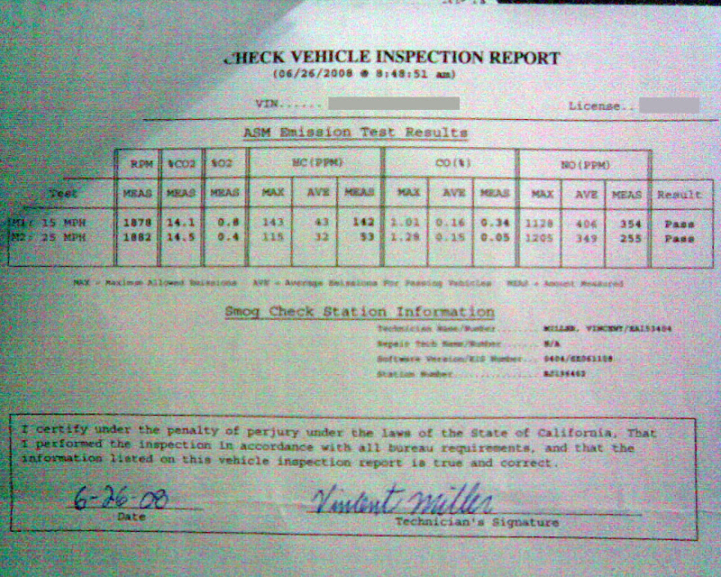

For anyone wondering, yes, the 261C "crawler" cam will smog in Cali. My truck is running great, a shade lean at idle (given the high HC), but it still passed first try.

Congratulations! You squeaked through, though. "142ppm", with 143ppm max, is close! (I believe "143ppm max" means "measured 143ppm fails", in CA)

Any idea why the HC is high at 15mph? I just did the street RV head and 261c cam myself but haven't been smogged yet.
Noticed that too, huh? Hey, a miss is as good as a mile, right? <img src="/forums/images/graemlins/smile.gif" alt="" />
Sorry it took me a while to read your question correctly. The HC is high because the idle mix is set too lean. Rich would be high HC and high CO. I still don't fully understand the method for setting the mix without an EGA, but I've got it running pretty well I think. Good enough to pass anyway.
