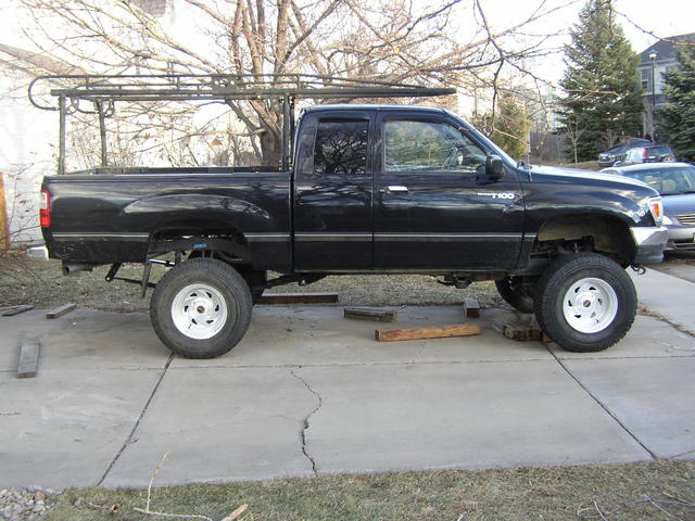

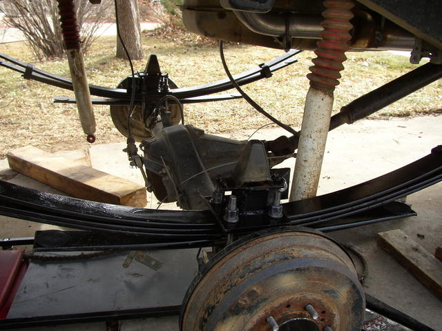

Hi everyone. I (virtually) completed my Chevy spring swap on my 1997 T-100. I put the bump stops up on little pillars so that the springs wouldn't go past flat.
The problem is that the spring travel is rather low. When the axles are suspended there is something like 12" between the top of the bump stop and the frame, but when loaded, it's something like 2-3".
Here's a picture the truck from the side, unloaded:
Here's a picture of the axle and springs without any weight on them. You can see the 12" or so between the frame at the very top and the bump stops.
Even so, the ride seems about right, but I think I'd like a little more travel before bottoming out.
So the question is, how much travel should I have in the springs when the truck is unloaded? Seems that what I have is rather low.

Those springs are very soft, which is why they ride and flex well. That's why I used a 4-leaf version on my truck and older 4runner.
So I guess what you're asking is how to get more up-travel (compression travel) from normal ride height?
I would say either add more lift or shorten your bump stops.

I think I'll add a leaf or two for lift then. I set the bump stops to touch at the point where the springs are flat. I've heard that the springs shouldn't go past that point.

Rancho makes a good add-a-leaf for those springs. Its a long, soft one, not a short stiff one that will eventually break the leaves above it.

A good spring shop can rearc the main spring for you

Thanks for that one too. I had forgotten about re-arcing the springs. I should probably weigh the truck and then talk to the spring shop to see what their thoughts are.
One thing that I don't know is how far a spring can bend before it's deformed. Then ask the spring shop to give it enough arc so that it will be an inch or three from that point when it hits the bump stops.
