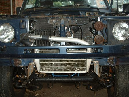

Where do you 2.6T guys put the intercooler?
Here's mine using Quest I/C but with the els reworked a little. I was stupid and should have just done the refitting with 2", as it has 2" hard pipes now. I made the riser-brackets you see to meet the stock tabs. The brackets are the bolted into existing threaded holes in the frame horns. I also have a Gen I V6 front skid. (Has a mesh opening at the top, like a Gen II, for air flow.)

My IC is mounted with the lower edge flush with the boom of the apron. I had a winch mounted in the space below that. You might consider an NPR or later EVO intercooler if you are going to use a 3.5 in there.

What about converting to a hydroboost brake booster system and getting a lot of mounting cubic inches out of the dside underhood? I still like the one big turbo idea, unless the exh path on the crossover is too long.
Since all the load the intercooler will see will be short bursts (I wonder how long it takes a TT Monstero to get to, oh, 140ish...), why not go water air and save that space, too. Or since you have all that room for tanks, methanol/water injection.
