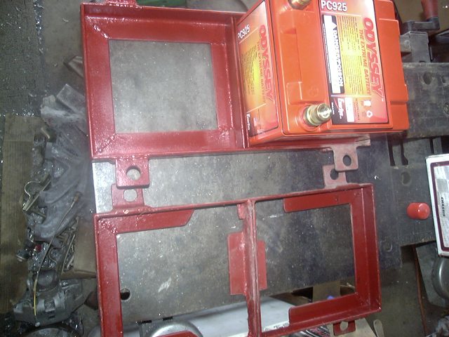

Battery tray/mounting details covered in the web page link posted earlier, some pix. below:
And the two batteries are bolted up underneath the truck:
I think they have a full/normal size battery now, but I have a pair of 925s in my 4Runner and a 1200 in my VW, that one mounts in the stock location:
All mine came with the brass SAE posts ready to drop battery cable clamps onto.

wow, you've got all sorts of mounting options going on there, Rog!

Roger, I see you have yours mounted away from the engine heat, a good idea...
