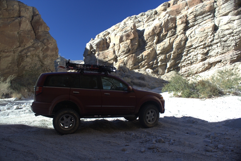

In my 2002 Rodeo 265 the tire was fitting fine. I removed some rubber stuff from the tire carrier, so the tire had more room.
I have exactly the same setup on 2004 Axiom. I additionally bended the metal carrier to get the spare tire closer to the axle, and I am fitting 32" without problems.
Wayne, just play around with the carrier, you will be fine.
May be, you need a modest lift - like 2" or so.
Check this image - the full-size 32" BFG offroad tire is barely visible, the underpinnings are exactly the same as on your vehicle:

Wayne, you have a right vehicle for the kind of travels you do. Scorpions probably the right tires, too; I'd get an LT version of the tire for reliability on the dirt roads.
I do not have the trailer hitch so I do not know what to say. With my experience with Rodeo and Axiom, I'd say that this setup can accommodate up to 32" / 265 tires, but I have no idea how about the trailer hitch.
