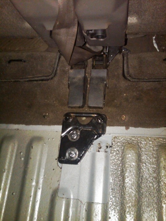

I'll try and snap a pic of hoop for that last part in a minute. If it's tooo dark, I'll do again tomorrow. When I did mine, I got some grade-8 bolts to fit the holes in the base of the hoop. I then used one washer on the top, as the plate is stout, and two washers stacked (each bolt) on the bottom. The first washer under the body it a larger diameter fender washer that had a larger center hole, then the second is a smaller washer that had an ID that matched the bolt. I epoxied each pair together first so I didn't have to worry about optimal positioning when working underneath.
The last part was to drill the hole in the floor. For that I dropped the seats onto the hoop and positioned it into a place where I was happy and then marked for where to drill. I used a bit slightly larger than the bolts so I'd have some wiggle room if need to ne sure the seats latched reliably.
Re: The Seats Are In (Sort of) [Re: MontyMcV] #990438 04/24/10 03:38 AM
Here's a pic. Only other thing that comes to mind is notice on the left side how I trimmed the rubberized layer on the floor just a little to get the bracket to set flat.
