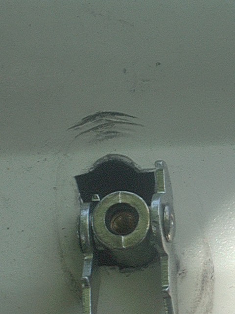

Problem installing after market antenna in the stock hole, the inner fender blocks the antenna base from fitting into the fender:

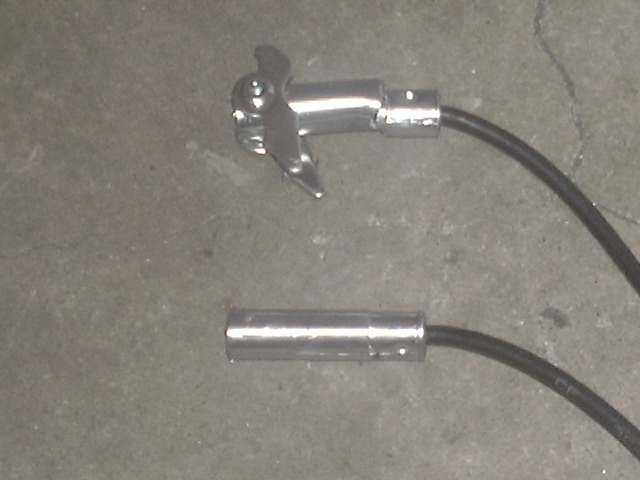

So first step is to remove the toggle clamps from the base:

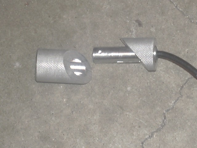

Then fab up a mount to allow the antenna base to go in vertical (1" alum. rod w/ 1/2" hole):
Antenna base comes up through lower half of mount, hole in fender, then the top half of the mount goes on and the base is screwed in and the new antenna is in (painted the aluminum mount to match the black antenna):

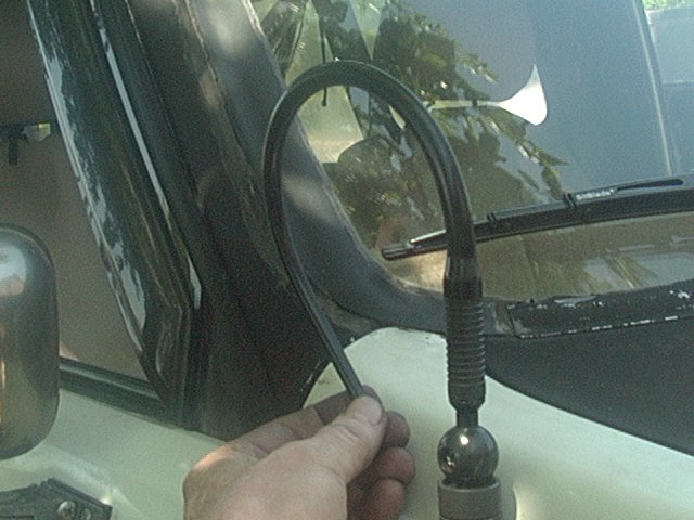

No way this one will break:

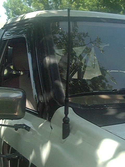

Seems to pull in stations at least as good as the stock antenna.
