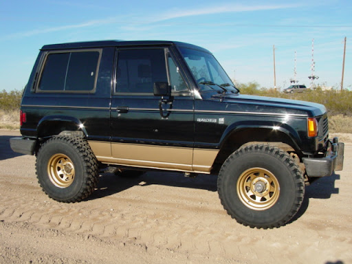

Re: 10 " rim too wide for gen1? [Re: 87monty] #998438 05/28/10 11:33 PM

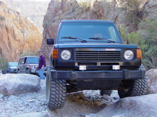

I rocked it:
Re: 10 " rim too wide for gen1? [Re: JohnnyBfromPeoria] #998439 05/29/10 01:13 AM
Joined: Nov 2008
Posts: 775
87monty Offline
Nice pic's there,, Well in that case I stand corrected, But It will come down to back spacing to get the sweet spot that you have on your rig...

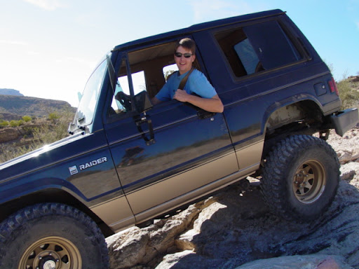

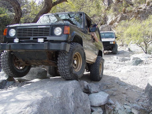

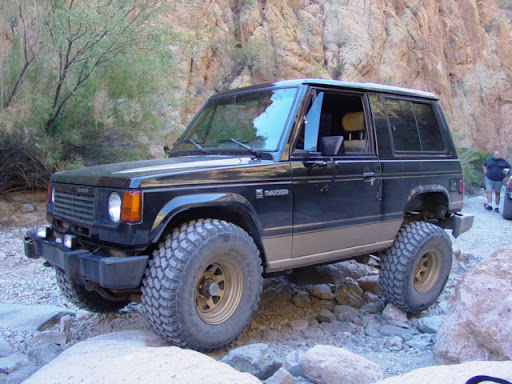

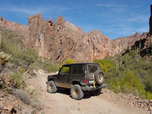

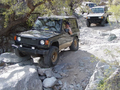

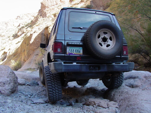

I've run 10" wide rims with 33x12.5 all terrains with no problems. My preference after using various rims is the 8" to 8.5" fronts that keep the tires within approximately 1" of the outside fenderwell. When I ran the 10s, the front tires were very exposed, threw lots of mud and rocks, and may have attracted undue officer observation. For my last set of 33" all terrains, I used the 8" front and 10" rear wheels. Though I couldn't rotate the tires, I had the same outside exposure of tread and the track width was pretty close to even.
The black Raider above has a body lift, therefore additional clearance at the leading edge of the front fenderwell near the bumper.
My Raider all flexed and no hitting:
32x11.5s on 8.5" rims:
Bad deal in this photo, the 32x11.5 all terrain on a stock wheel sat too close to the frame and rubbed all the inside of the rear fenderwell:
Necessary clearance points on the front with 33x12.5s on 10" rims...just where I showed you the other day:
10s front and rear with 33x12.5s:
