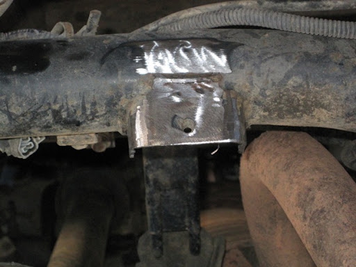

I put the body lift on a few months ago and finally got around to lifting the gas tank.
First I drained the tank and removed it, which took much longer than I expected. When I did this on my 95LS many years ago i cut off the original brackets and welded on a set of lame and probably very week brackets. This time I decided to use the original brackets in the front and just cut them down. The one rear bracket I cut off and then I welded 3 pieces of 1x1 angle on the rear cross member so the seam of the tank sits just at the top of the cross member.

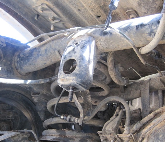

Here's the original bracket at the front of the tank.
Cut it off almost at the top. the hardest part was getting the cuts clean & straight so I could weld the two pieces back together.
Don't get your finger too close to the grinder when you are cutting.

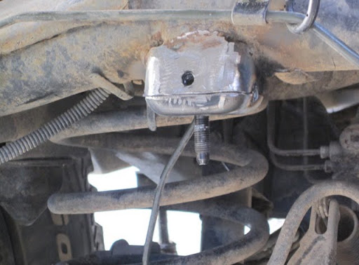

Here's the pic after I cut out the middle 3 inches and tacked the bracket back together.

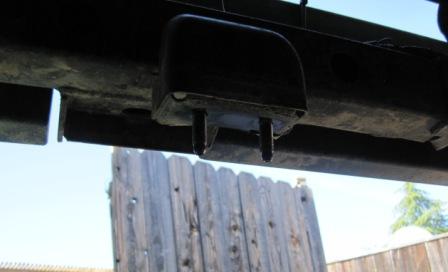

That's the rear bracket I cut off

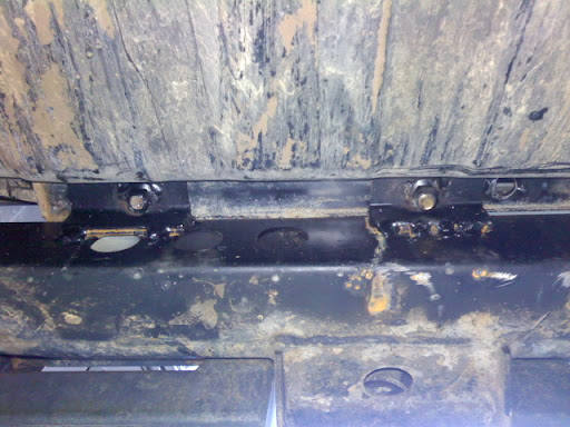

I forgot to take more pics while I was working so here's 2 of the three rear brackets that I welded to the rear cross member. The bolts come down from the top.

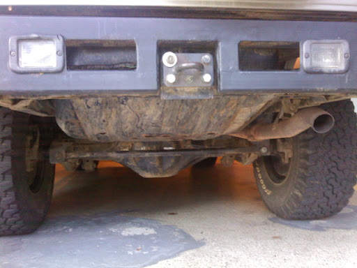

And lastly here's how it sits once it's raised 3" in the front & 5" in the rear.

Nice work Kirk. Been dragging my fuel tanks over stuff for 15 years, but after dragging my tail in Moab a few weeks back, it really gets me thinking...
Great job grafting the two pieces together on that bracket!
