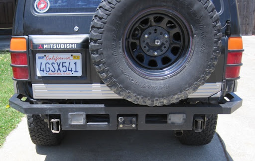

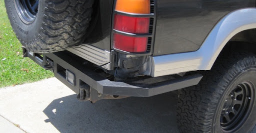

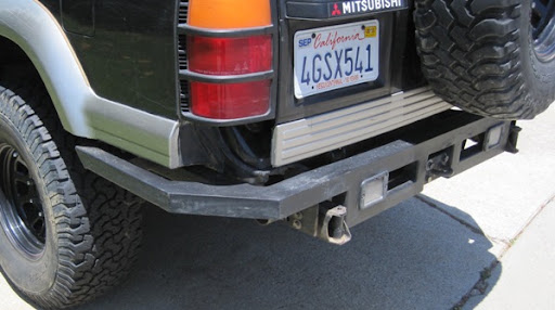

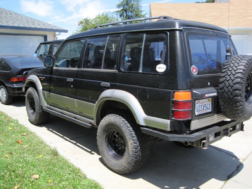

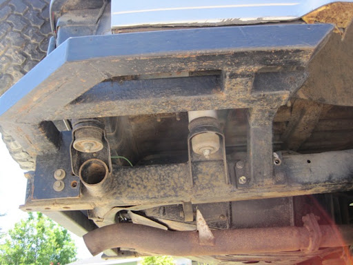

I actually made this a few years ago but I never posted pics and I forgot to take pics during the construction. It's 2" box 1/8" wall. this was the first project I did with my home center special stick welder.
If I had to do it again I would cut the end of the frame rails so I could extend the lower portion of the bumper another 3" toward the outside. Also after I had it mounted I realized that it wasn't far enough to the rear so that could step on it when the rear door was closed so I added another 1" in depth with a piece of 1x2 channel.

Looks good man. If you would have posted it when you did it you probably would have beem one of the first to have done it. Hows the truck look overall? Lets see some more pics.

Thanks Kirk - looks very sturdy. And the lights in there make it almost oe! <img src="/forums/images/graemlins/lol.gif" alt="" />
Nice work.

The design and execution look great. Only downside I see is the 1/8" wall. IMHO, it's a little on the thin side if it's going to be used to hi-lift on... Or have you done that already and it's held up?
I do really like the reverse light integration. Super slick... <img src="/forums/images/graemlins/kewl.gif" alt="" />

Thanks everyone. I have used the hi-lift a number of times without a problem. I chose 1/8" because of the weight. picking up the thing now I just couldn't imagine it weighing twice as much. I'll post up a couple more pics of the rig a little later,

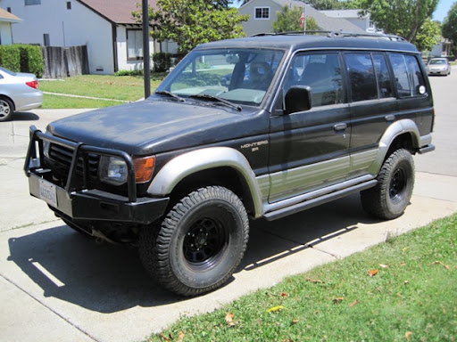

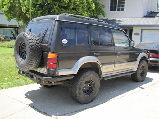

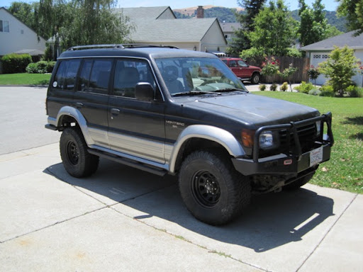

Here's a few more pics.

Nice custom bumper, so what happen to the '95? I really love these gen IIs, though I can't wait to get a gen III for my wife and daughter someday too...oorah!

The '95 is in my garage with a dead transmission. I could have replaced it but there were a number of other things wrong so I decided to get the '96 with the 3.5. I'll probably part out the '95. I figure the 5.29's and the ARB locker should be worth enough for me to buy a set of 3.15s for the t-case.
