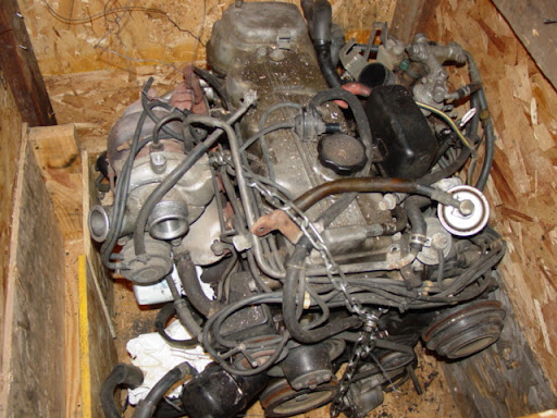

Your pile o' stuff will look something like this:
Re: Prepping my self for the SQ swap [Re: JohnnyBfromPeoria] #1001351 06/28/10 02:34 AM
Don't need the fans...
Re: Prepping my self for the SQ swap [Re: fasteddy] #1001352 06/28/10 08:28 AM
They got thrown in, along with the associated relays. No extra charge. I discussed this with the OP and his son when they dropped by. Stock photo footage from years ago...when I thought I was serious about actually finishing this project of mine. I still have it all, just a little dustier these days...
