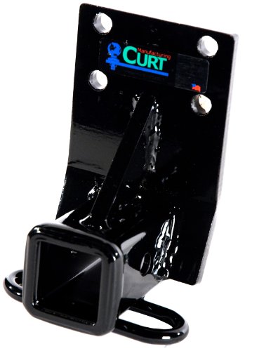

Thought I would let everyone know if you are looking for a hitch with a 2" receiver compatible with more accessories, this one will fit with a little persuasion. All that is needed is to trim 3/4" under the bumper to allow clearance for the angled support. Then bolts right on. Just remember this does not increase towing capacity!

strange, but when i looked up curt 13091, 2 different hitches come up, but I think you are talking about this one, right? [Linked Image]

Class IIIs attach to the frame rails AND the four center bolts.

That style is really secure feeling. I found one on a 91 LWB and adapted it to fit my 87 Raider. trimmed the frame mount on the reciever, then made and welded brackets to the frame. SOLID! <img src="/forums/images/graemlins/kewl.gif" alt="" />

I'm sure it is adequate for most things we tow but from what I've read that can't be a class III. Dropping the receiver off of those bolts and towing anything big creates leverage loads that those bolts (grade 8 or otherwise) aren't engineered to handle alone.
Class III on my 98. <img src="/forums/images/graemlins/cheers.gif" alt="" />
Not sure what class this would be, but I notched out the existing four bolts on my 96 and welded the receiver right to the frame and beefed it up with 1/4" plate steel. This really makes the trailer feel like part of the truck and the departure angle is still the same. Since the geometry is the same as a class III hitch and the frame steel is beefy enough I'd imagine this is close to class III.....given my welds are worth a crap. <img src="/forums/images/graemlins/smile.gif" alt="" />

Yes this picture is the correct one.

Agreed I would not tow more than 2000lbs which is what my 2.8L is rated for. But this is perfect for bike racks, cargo baskets, small trailers....
