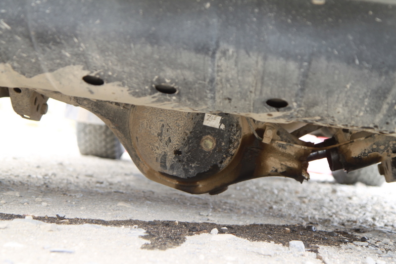

Hello all. I picked up John D's 89 V6 3.0 Raider last week, and took it to the trails in DV over the weekend.
Seems like there was a small crack under the rear axle that was previously repaired. I eventually managed to destroy it. Hooray! <img src="/forums/images/graemlins/butwiggle.gif" alt="" />:

Anyway, I (obviously) need to swap it out with another axle, and I have a few options at the local yards.
89 Montero V6 (Pick n Pull, 15 min drive)
91 Montero V6 (Pickup, 1hr drive away)
87 Raider (unknown engine, Pick n Pull, 30 min drive)
Should all of these bolt on and work fine?? The first two Monteros have coil spring. For the Raider, will the rear axle differ between 2.6L and 3.0L models?

Damn!!!!! <img src="/forums/images/graemlins/zombie.gif" alt="" /> that's crazy!
Either V6 axle should work, I'd pick the easiest one to get. If the prices are similar.

I know you probably need to have it drivable but the gen 2 SR axle swap will be best.
Re: First Post - Exploded Axle Fun Times, what to swap? [Re: TOASTY] #1028085 05/12/11 08:00 PM
Boy, that looks VERY FAMILIAR!! Happened to me on our Sierras Rubicon Run one year. It does happen with the gen I axle housings from what I've heard overseas but not as common to see here in the States.
I replaced mine on the trail with one out of an Gen I LS but I agree... an SR axle and trailing arms would be a nearly drop in solution (will need to install the SR compressor or equivalent) and the locker switch.

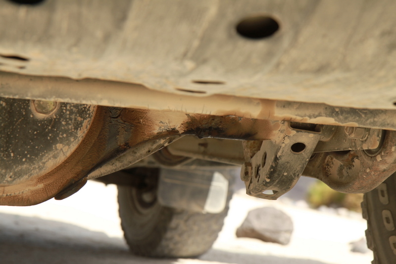

Just curious, were you running a rear anti-sway bar and what shocks were on the truck when the breakage occured? ( just curious about a theory I've had for a long time...
Good question Justice... It's kinda hard to tell but the 2nd pic has what looks like the antisway bar but I could be wrong about that...
Remember though, John already had a broken trailing arm when I was down south doing the Miller Jeep Trail. We didn't discover it until the end of the trail but fortunately before it completely broke in two. He said he was able to get it home safe and swapped in new trailing arms. I guess it is possible we still stressed the axle housing enough from that trip to fatigue it. <img src="/forums/images/graemlins/frown.gif" alt="" />
