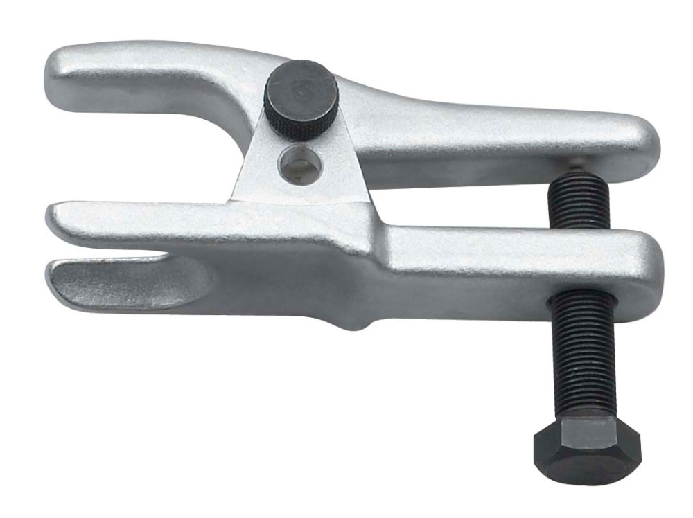

Or you could look at your local stores for the correct Mitsubishi tool like this.
http://s7.sears.com/is/image/Sears/00996404000?qlt=90,0&resMode=sharp&op_usm=0.9,0.5,0,0

I've never been able to find that tool in a large enough size to fit around the fat montero balljoint. Ordered 2 different ones from NAPA from their big fat cataloge that were too small, I guess they fit toy 4wds like nissans and such.
