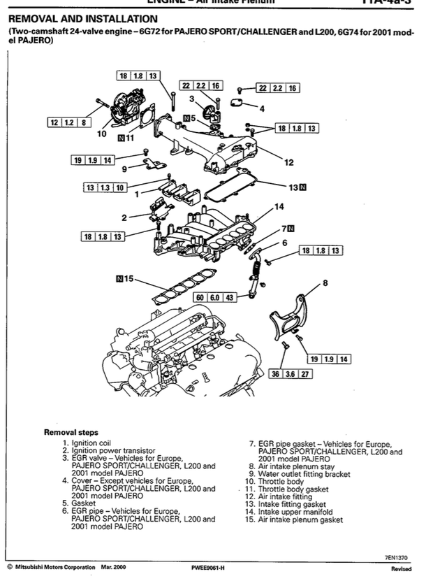

Re: Advice for a first time Montero SR Owner [Re: MMeadows] #1101823 07/25/16 05:13 AM
Joined: May 2016
Posts: 41
MMeadows Offline OP
Changed my plugs , plug seals, valve cover gaskets. It took about 6 hours. It was in my opinion an very hard job. There is not real service manual online for this car. The link in the sticky is broken, did some google searches as well. The factory service manuel is horrible. Ive attached a picture of the instructions. These are very incomplete and does not really cover any of the wire harness, show you a firing order, tightening instructions. Just about every intake bolt has a bracket on it holding something. Definitely make a card board cut out to keep track of the bolts. There is a thread hole in the manifold and a hole in the gasket for a bolt but one does not go there, Must be from a different application.
Anyways my car wont start now. Kind of sucks. lol going to hope there is a forum that discusses firing order on the 3.5 sohc as the manual says nothing. I did try hard to keep them in order but its the only explanation for it not running. [Linked Image]
