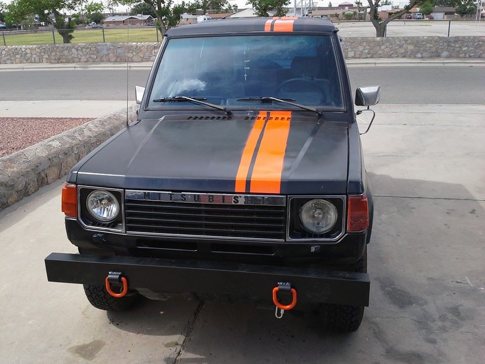

You pay shipping, I have a 97k mile short block you can have. Source is an 86 Montero.
96035
Re: Running out of engine options, will this work? [Re: DRTDEVL] #1102136 09/24/16 05:35 PM
There are some swap alternatives here, but see Toasty about the 2.4L FI.
El Paso CL
El Paso CL
