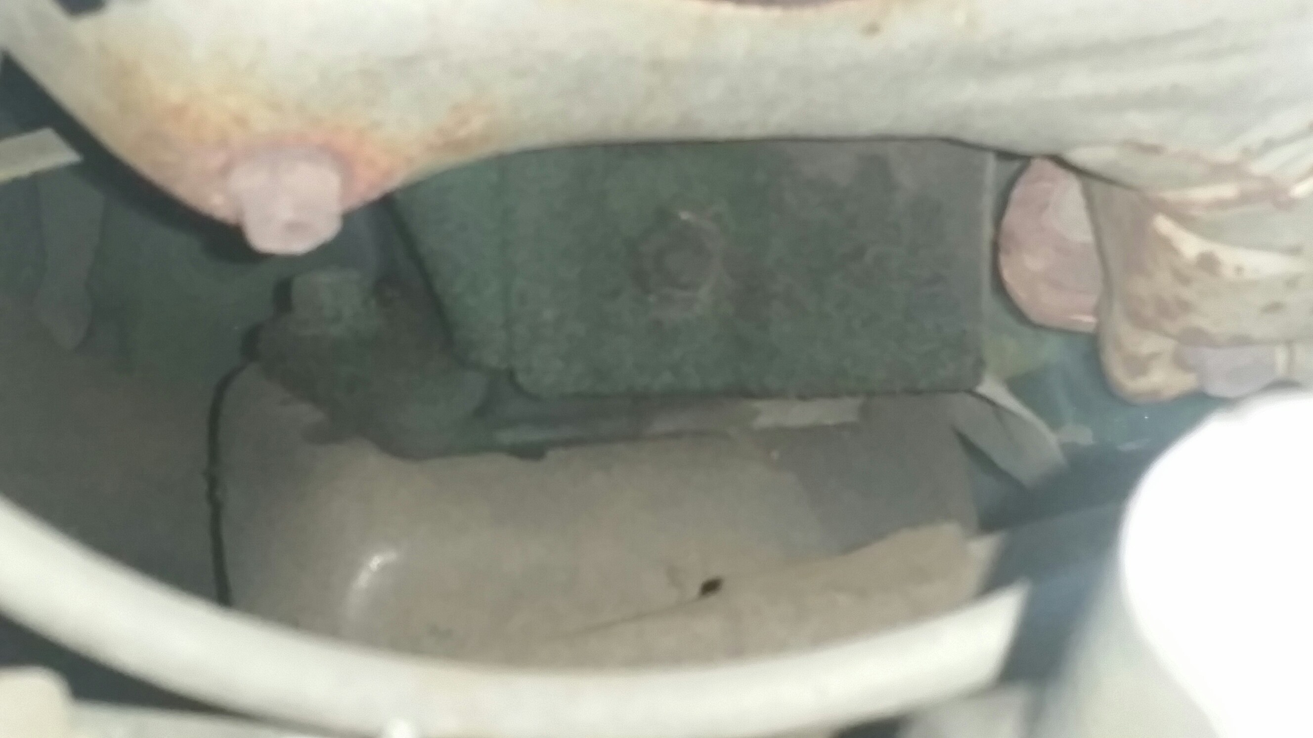

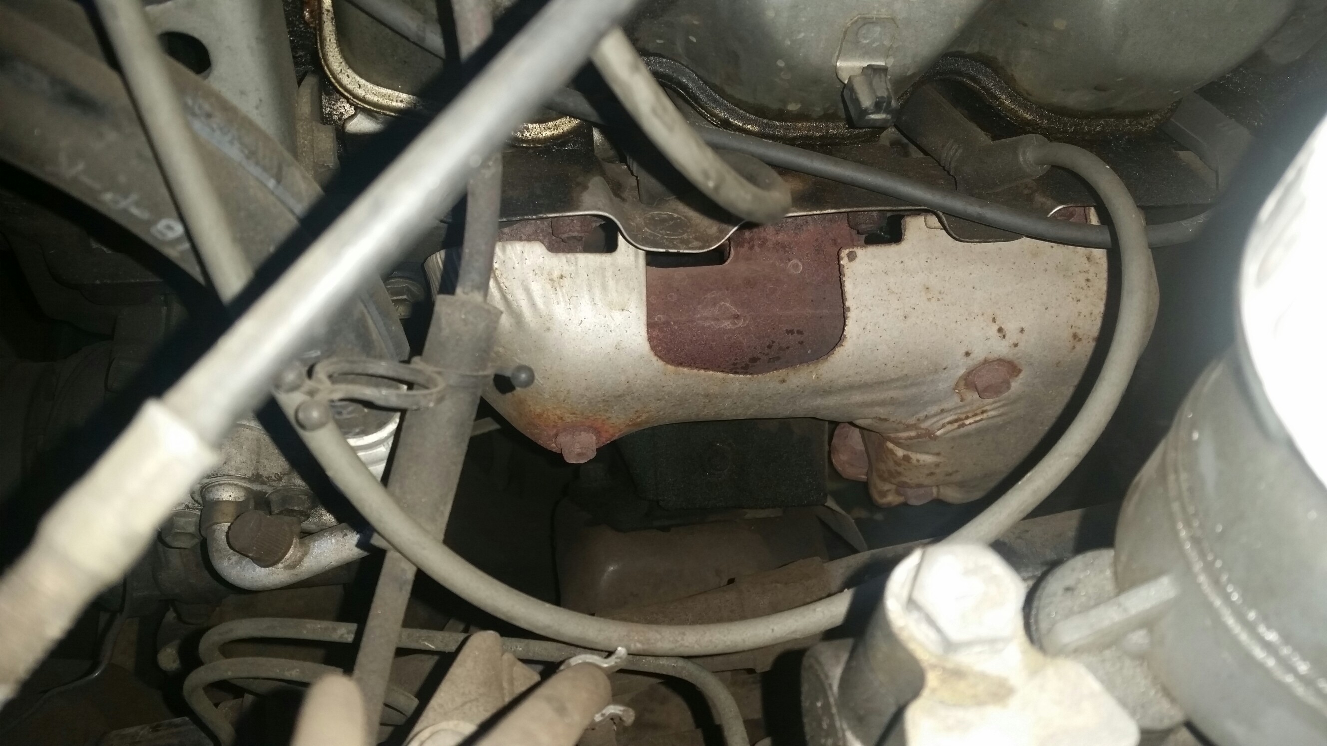

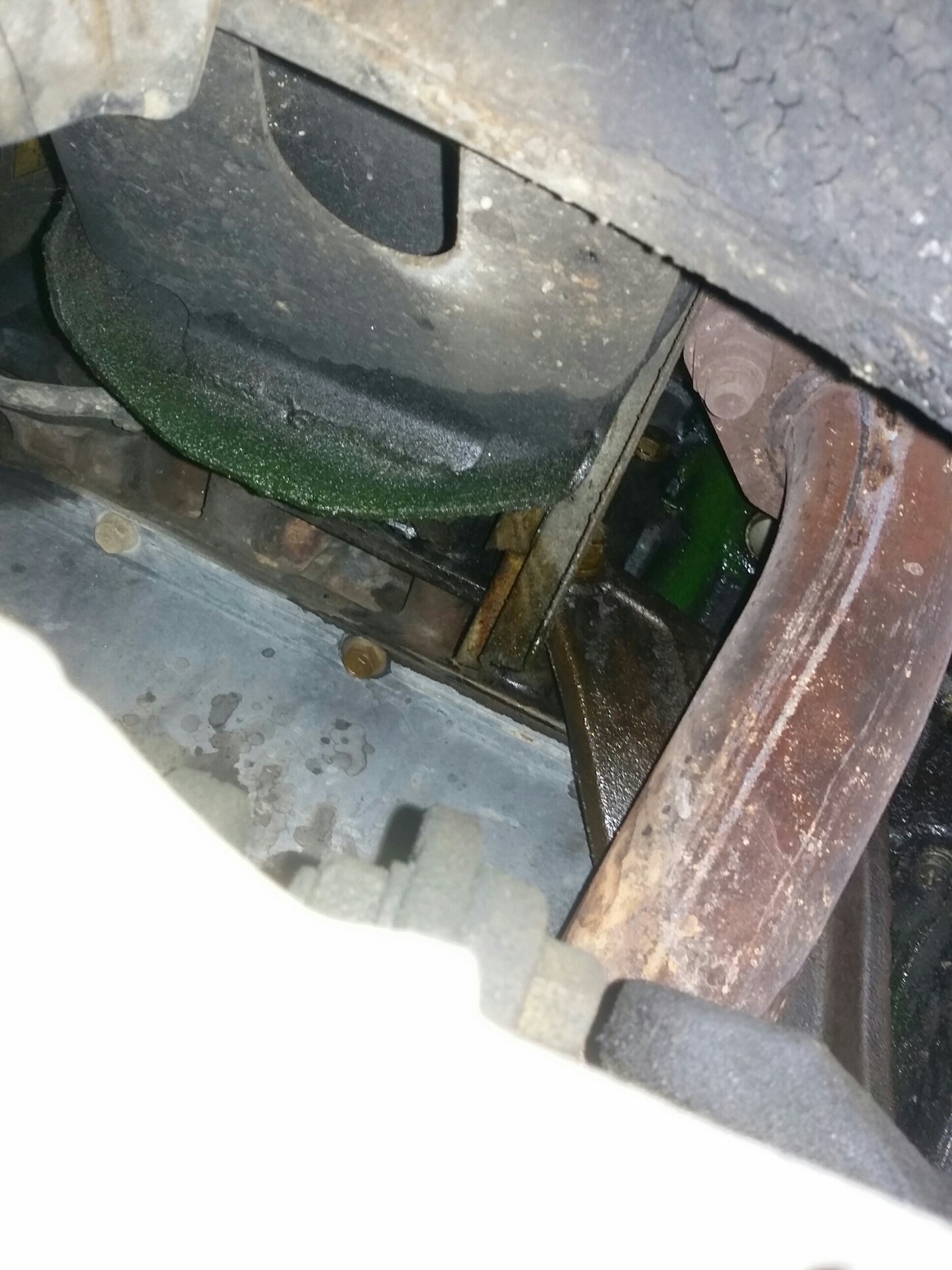

But yesterday I noticed smoke coming out of the hood. Upon further investigation I noticed the smoke (sweet smelling) is coming out from below the manifold somewhere on the driver's side. I can't tell where from. There is definitely a coolant leak of some kind, as its slowly dripping onto the ground (8" diameter damp spot on the driveway after sitting overnight).

Pics: 1st one is same location seen in video, 2nd shows A/F covering motor mount on drivers side, 3rd shows view from below

I'd start with the flashlight inspection of the gallery between the heads. The weep seal on the waterpump and the o-ring for the transfer pipe are always as likely a suspect as Col. Mustard with the pipe wrench in the study.
