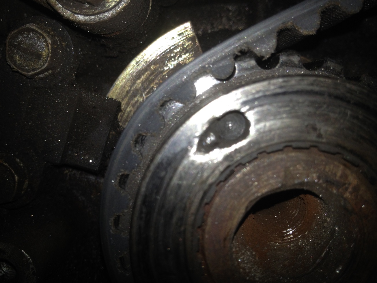

Thought the crank bolt had sheared (of course), but it was in place and the balancer was really loose. Figured it had just sheared the roll pin, so I tore it down, expecting to do that - the PO suggested putting a solid pin in there (I figured I'd bring it to a machine shop and have them do it). Turns out the crank bolt was hand tight - I removed it with my fingers easily. The balancer and crank sprocket are pretty shot. I bought a new balancer, but as I expected that it had just sheared the roll pin, I haven't bought the sprocket yet (I do have a new crank bolt and washer on the way).
But the worrying part is that the crank threads have lots of little metal shards in them - the threads on the bolt are perfectly fine, but I think that it ate up the crank ones a little bit (there aren't whole threads, just lots of tiny shards). It goes back in, but gets pretty tight pretty quick - I'm worried about damaging the threads, so I haven't torqued on it with a wrench.
I'm obviously fine just putting a thread chaser through it and cleaning them up... but its the crank bolt. Is that ok? Would this be something that would be better a machine shop do than me?

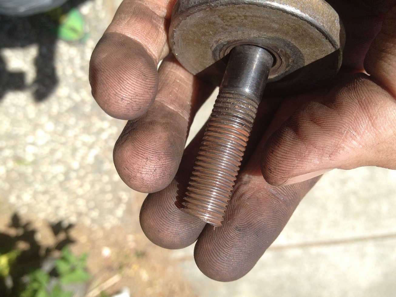

I was wrong - and the question has changed. The bolt is sheared - ~51 mm from the head. Did it sort of cleanly, so it wasn't particularly obvious.
I'm fairly certain that I can't extract it that far down, especially since its the ARP one.
Is the motor toast? (i.e. new crank, bottom end rebuild necessary?)

The crank bolt is 2.03" long now, ARP says it was 2.47" originally. .44" doesn't seem like that much to drill through, but on the other hand, the bolt is really dense, and it is ~1" into the crank where it broke. I talked to the PO - he tapped the crank for the ARP bolt (its a small block chevy, 13/16" bolt). So I'm definitely not going back to the updated Mitsubishi bolt.
I've drilled out exhaust studs and stuff (from motorcycles, mostly), but this seems like quite a bit deeper and far more exacting than those. And if the ARP threads on the crank are damaged (which I think they are, but its possible that the shavings were mostly from the broken bolt, but that seems unlikely/overly optimistic), I'm going to have to figure out something to do with them, too.

If the broken bolt is not rusted then it might not take much torque to twist it out. Getting the hole drilled on center will be tough without a jig though. Maybe you can use the broken bolt to make a jig then screw it in to get center hole.
Get some penetrating fluid in there.

That's a really good idea. Put the broken end in a drill press and carefully center a hole. Then screw it in and continue the hole.
I'm currently waiting on parts to do my timing belt right now on my MIVEC DOHC V6 so I understand the space constraints you're dealing with. I previously had a 3.8 crank bolt (on my wife's gen3) come apart on the highway a long way from home due to an improperly torqued/dealer installed crank bolt, with catastrophic results. The shop it was towed to (too far from home for it to be worth it to do it myself) used an insert on the crank, and was able to properly torque a new bolt in there. Its been good for three years now, and about 50k kms, so it can be done successfully.
I think so far you are going about it the right way. Good luck.
