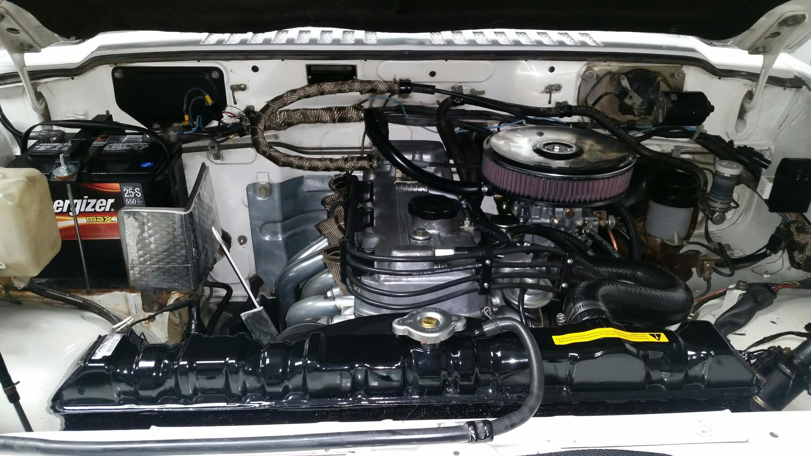

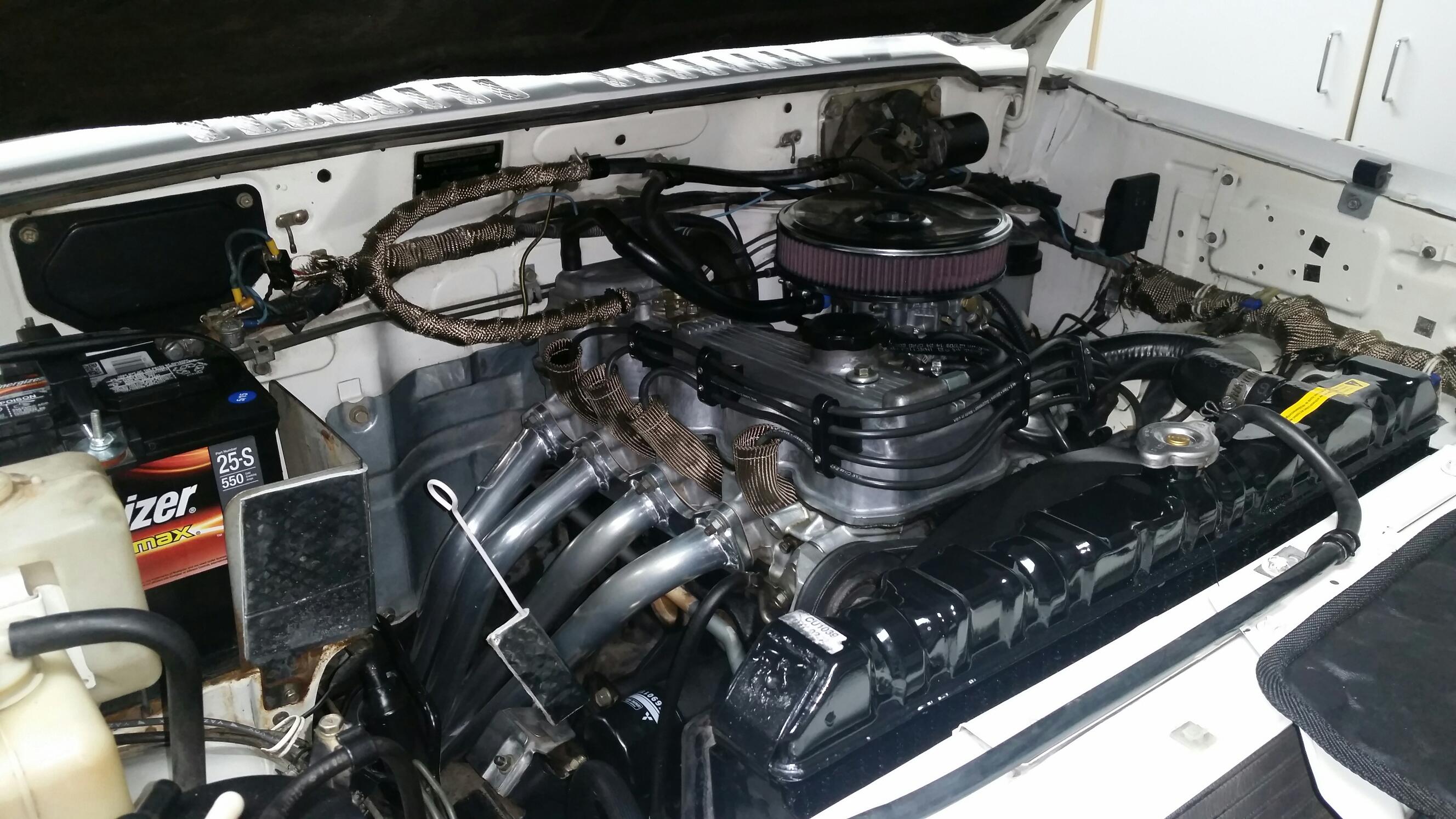

Here's a couple of pic's of the header and Weber, KN Apollo cold air intake in the works.....
Re: Carb Question [Re: 87Raider] #1104222 03/02/18 03:44 AM
Pretty, pretty
