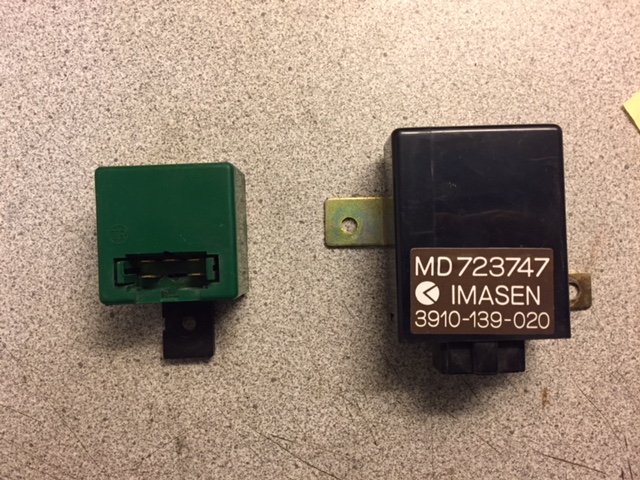

I am trying to specifically identify what these two relays are. I have a 91 Montero and they are both located in the passenger side foot well area.

The larger one is for the auto hubs lighting circuit. What are the numbers on the greenie one?

Thank you. Green one has no part #'s on it.

Where in relation to the other do you think the green unit occurs on the wiring schematic? What color wires in the plug?

The green one is the rear window defroster relay.

If it's good, keep it dry and happy. 2/3 of mine were corroded to disrepair. No way to fix them. Both of them forced the defogger power on constantly, be that good or bad.
