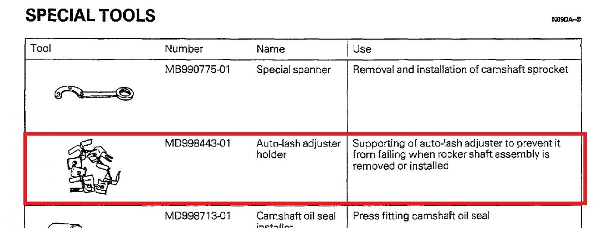

I removed the rocker arm assembly from a SOHC 12 valve head. Now I'm trying to get it back together.
I see mentioned a tool for compressing the valve spring to open the rocker arms sufficient to slide the adjusters in place, but, that tool is for the DOHC engine and doesn't fit in the SOHC head.
What do I need to do?
Re: Need Help - SOHC Valve Adjuster Replace [Re: tdf46] #1104450 07/03/18 05:23 AM
Open the pic, has the tool part number and description

Thanks Russell,
At some point in my googling I saw this tool but didn't catch how it worked.
