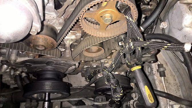

I had to lock it from the can gear using a rope.
