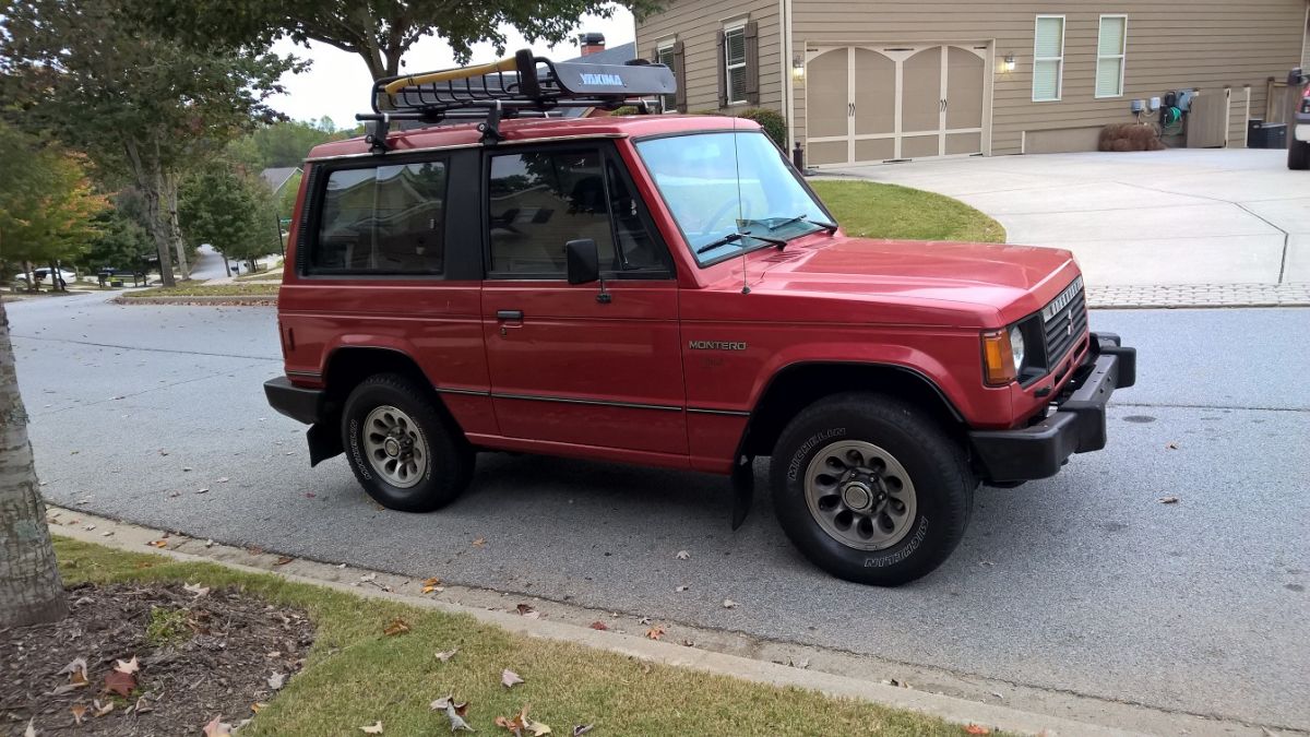

Hmmmm I am looking to keep my rims but they are 15" I love the way they look.
Javy
Javy
Previous owner swapped out some 16ÔÇØ Toyota 4-runner wheels on mine, but the junkyard one I found had OEM rims on it and seeing yours I want to snap them up now.
