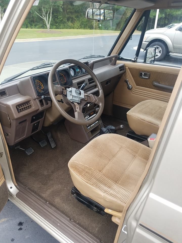

Ah shoot, n00b move on my part. Here's photos of the exterior, interior, and engine bay as it currently stands. I took the radiator out to give it a good flush since it more than likely has some oil in it with the blown head. Previous owner was having issue with the horn. Pulled it apart and didn't put it back together, but luckily gave me all of the pieces, so that'll be another thing to do once all is set under the hood.

Looks like it's in pretty good condition, very similar to mine - we have the same interior!
The vacuum control unit on the driver's fender should have nothing but wires running to it at this point; you can disconnect those and remove the unit if you so desire. You can also remove the ECU in the passenger footwell, as it no longer does anything with the Weber carb.
