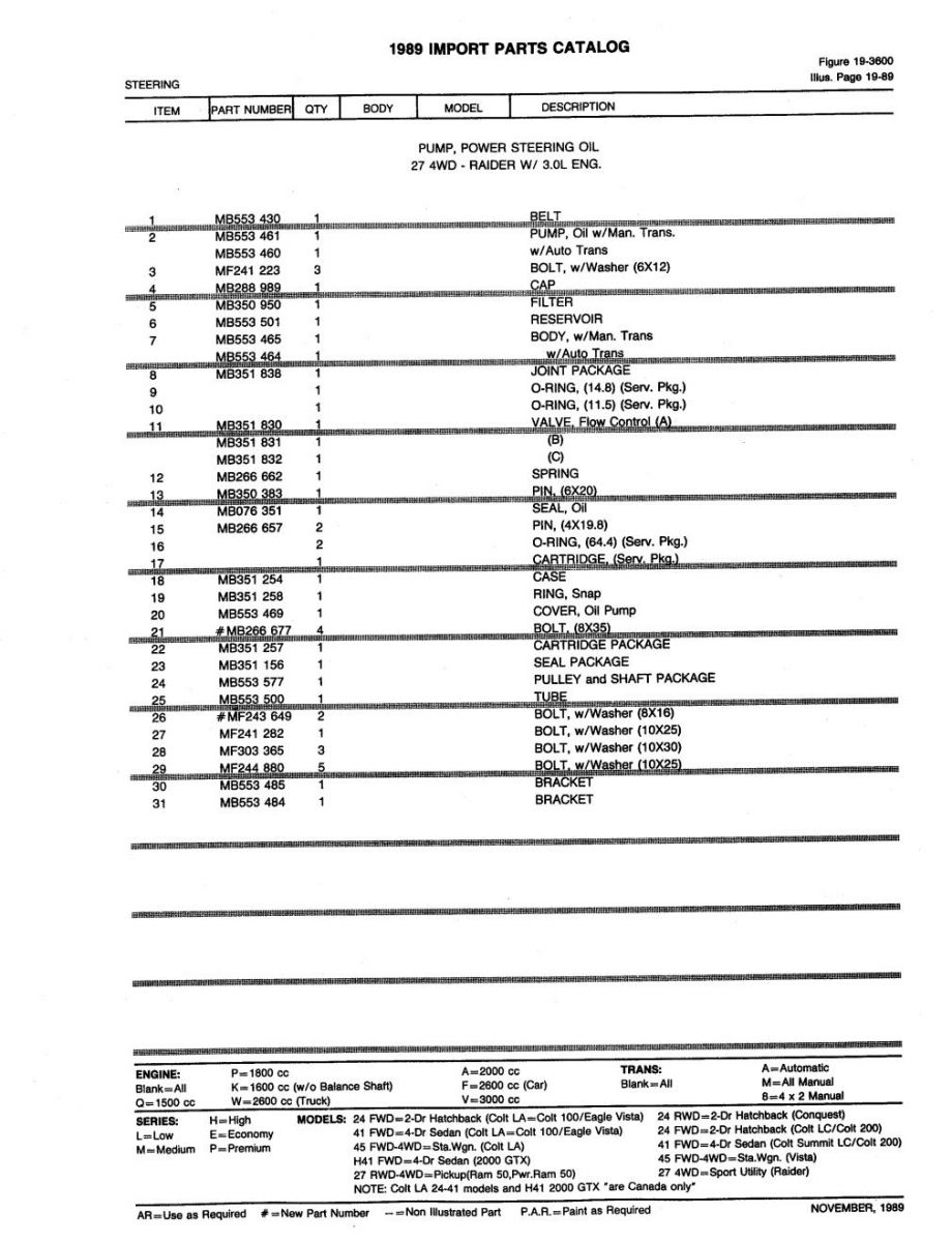

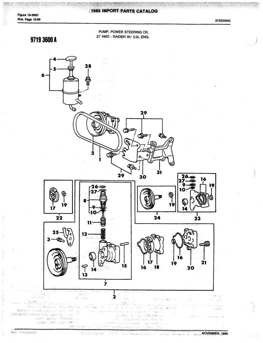

Refer to the attachments for parts diagrams.
Here's what it took to re-seal the power steering pump on an '89 Raider SWB with a 3.0l V6 engine w/ 5-speed manual transmission.

-Once the outside is as clean as can be reasonably attained, use the 10mm socket to remove the bolts holding the supply feed tube plate (25). There is a small o-ring on the back of this, discard it. Fluid will likely come out behind this.
-Next, clamp the assembly in a bench vice and, using the 12mm socket loosen and remove the four bolts holding the back plate (20) on the assembly. More fluid will come out.
-Set the backplate aside, remove the odd-shaped o-ring (16) from its groove (or from the backing plate if it stuck) and trash it.
-Using snap ring or piston ring spreaders, with the help of the dental pick if necessary, remove the circlip (19) from the end of the pulley shaft. Discard the old circlip.
-Slide the pulley shaft (24) down and out of the pump body. Inspect the shaft for signs of wear.
-Gently wiggle the case (18) up and off of the pump body and set aside. Remove the other odd-shaped o-ring (16) and trash it.
-There are two parts of the cartridge (17) though the parts diagram shows it as one piece, there is a oblong collar and a round center piece with individual "blades" within it. Make note that the central part of the cartridge has a top face and bottom face. The top face has a small hole on the surface which the bottom face does not. Also, the top face has a slight recess around the splines. The assembly will not work if the cartridge is installed upside down. Lift the outer collar of the cartridge up and off of its guide pins, then gently remove the cartridge (17), taking care not to allow any of the individual plates to fall out. If they do, be aware that there is a rounded face and a square face on the narrow edges of each one. The square face needs to orient in to the center of the cartridge so that the rounded face faces out.
-Lastly, using either a deep well socket or a large crescent wrench, loosen and remove the joint package (8). Be aware that the flow control valve (11) behind it is spring loaded and will pop out upon removing the joint package. Remove the four o-rings on the joint making note of their different sizes and which one goes where, then discard the old o-rings.
