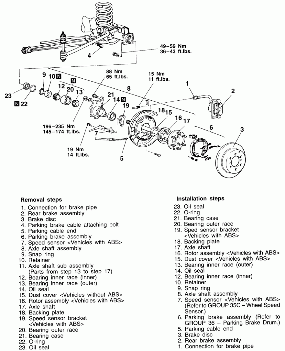

Where can I buy the o ring for the rear axle? This thread does not mention where to buy the O ring. The O ring does not appear for sale anywhere. Is there a compatible substitute? I have the leaking axle fluid in the passenger side.
Axle diagram 3.0L

Do you have the 89 Parts manual? If not, you can download it from mitsubishilinks.
I'm guessing you are looking for MB092440. It's available for $2.50 from mitsubishipartswarehouse.com. It looks like it was used on many models, all the way thru 2004. You shouldn't have any trouble finding it.
