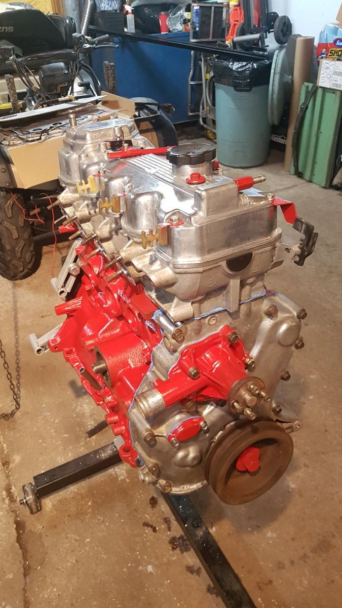

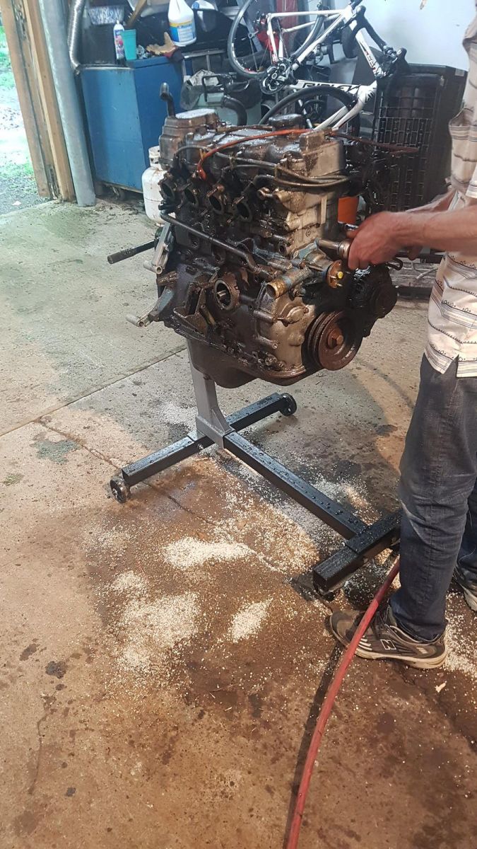

Before and after rebuild. ready to breathe new life in the old girl. should go in next week.

my donor engine had 170k on it. all journals were within spec, so no oversized needed. I bought the rering kit from rock auto and various other parts. not the complete kit as I didnt change the pistons. the rings I also bought at stock sizing. hardest part was putting in new balance shaft bearings, a very steady hand and 90 bucks worth of messed up bearings later.....

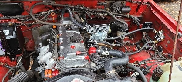

Well, my first 2.6 blew a head years ago before I knew anything about them. The second one was a refresh that skipped a balance shaft and blew apart, this is my third engine just rebuilt. Hopefully the last lol.
I put 150 miles on just did an oil change and now that things are broken in a little I started swapping in the weber.

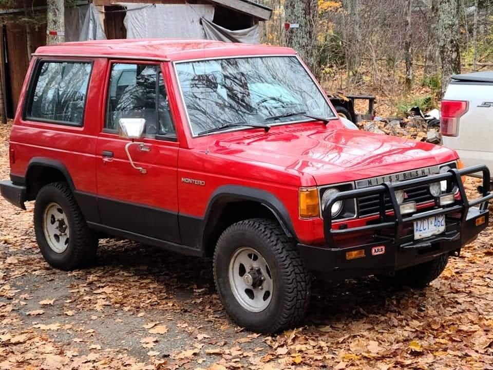

Finally finished. Should have put a weber on years ago. And since I've never been able to figure out how to embed pics. They're attached below
