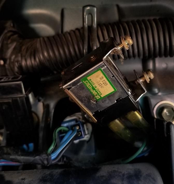

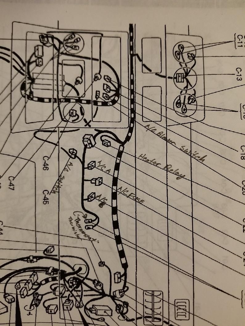

Thermal switch. It's a weird relay inside of the dash assembly on the passenger side, behind the glove box. This thing basically has a temp probe in the Evap coil side and switches the compressor on and off based on the evap coil side temp. This ended up being the source of the issue on my Monty, so I just bypassed it with a blade-type fuse. I run the risk of icing up the coil, but I'm good with that slight possibility. This is also the area where two of the other relays involved in the A/C system are mounted (shown in one of the attached images).

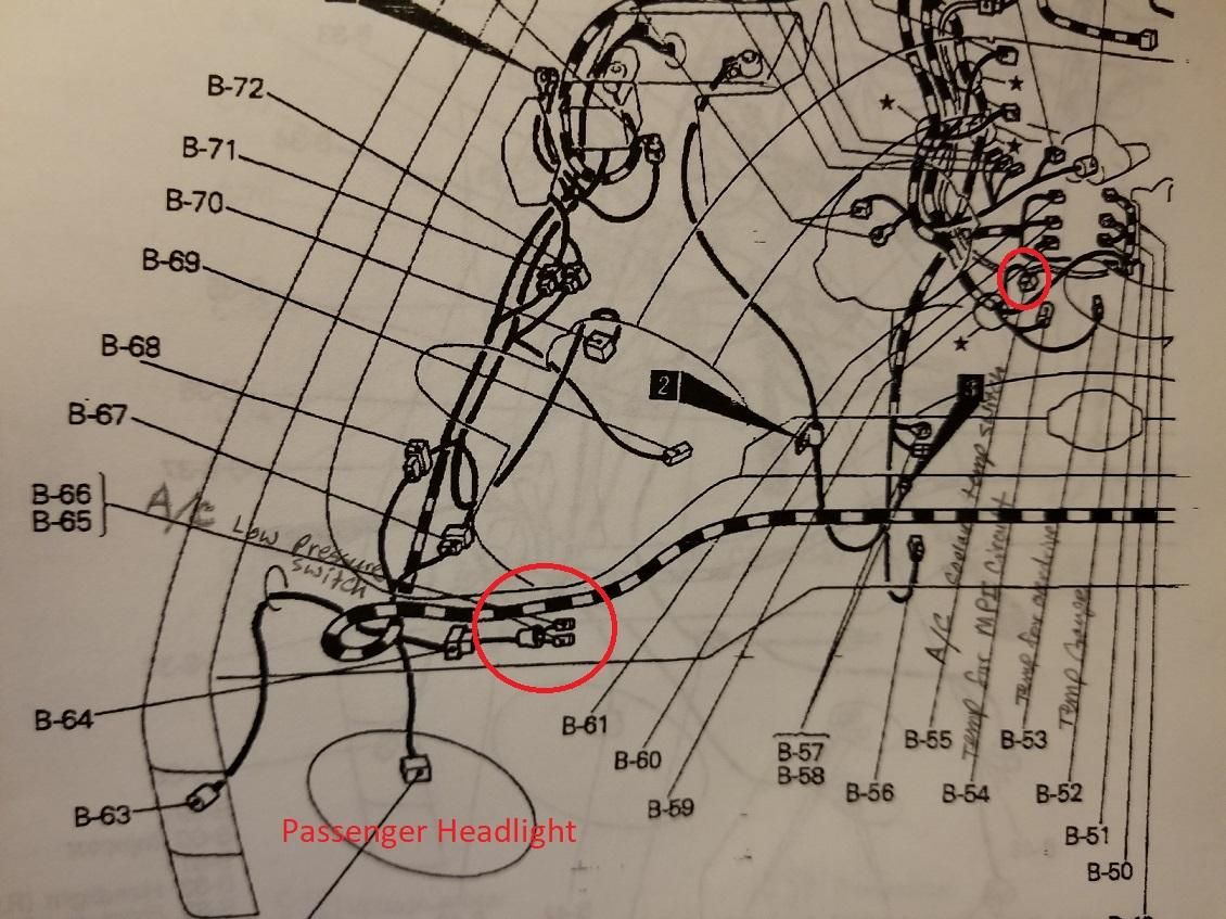

Low pressure switch. This is on the high-pressure side of the system and is screwed into one of the hard lines behind the grill, on the passenger side. It can be tested with a simple continuity test.
Engine coolant temperature switch. On my 3.0l it's the passenger side sensor closest to the firewall.
