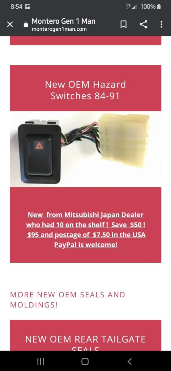

Re: Hazard Switch gone bad, no lights. [Re: Trailmonkey] #1105784 10/23/20 11:36 PM
Joined: Aug 2020
Posts: 191
Trailmonkey Offline OP
This one.

Re: Hazard Switch gone bad, no lights. [Re: Trailmonkey] #1105796 11/03/20 02:22 AM
Joined: Aug 2020
Posts: 191
Can someone take a pic of the wires on the back of the switch for me ? So i can color match the wires on the correct locations please. This manual does not match up properly.

Re: Hazard Switch gone bad, no lights. [Re: Trailmonkey] #1105800 11/05/20 09:47 PM
Joined: Aug 2020
Posts: 191
No one has one they can take a pic of to help me out ?
It would help so many if we could know what wires to just solder together that have a bad switch, id rather not have hazard flashers and have my brake lights-turn and tail lights work.
