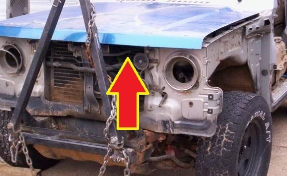

You don't specify the model, and I'm going to presume a Gen 1 in this example. Therefore, please refer to the attached photo.
A. With the bumper and skid plate removed for access, reach up behind the grill until you encounter the cable housing.
B. Cut cable housing apart, as pry in an arc to expose the cable core.
C. Pull on the core with some pliers.
D. Pop the hood.

Problem Solved!
I reached up to the cable from underneath and was able to pull on the cable with a long set of visegrips to release the hood. Once open I could see the hood latch return spring had snapped in half and therefore the handle wouldn't reset.....so off to Tractor Supply for a stiff enough spring ...Actually $5 for two springs but now got extra. Just had to cut it and reattach and good as new!
