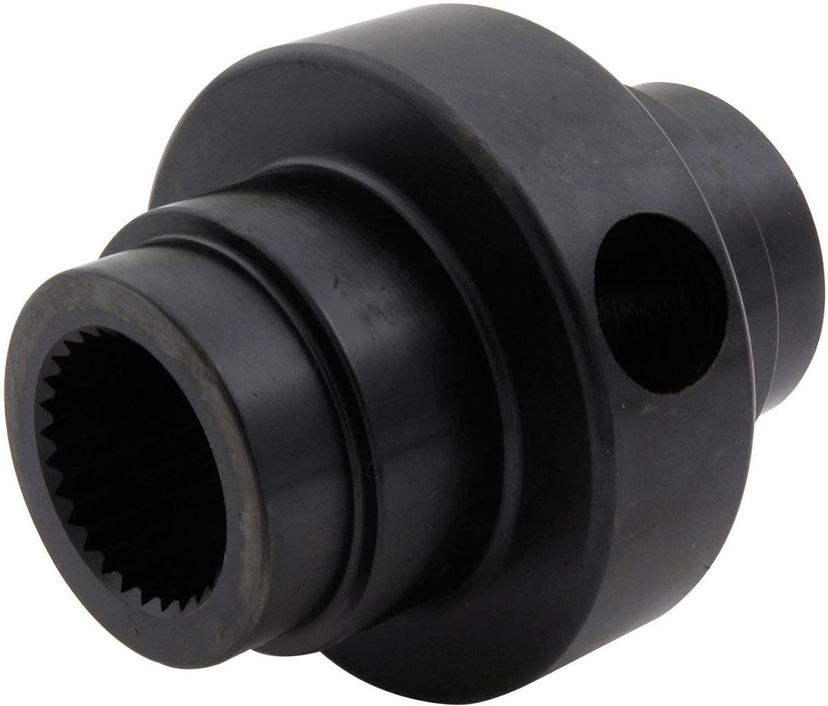

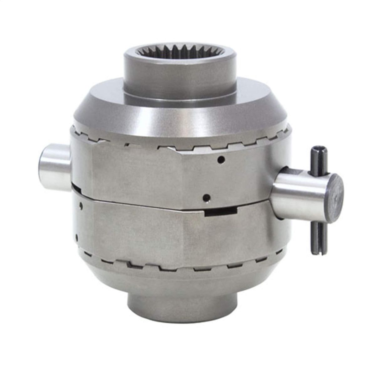

And no I'm not even talking about the carrier the ring gear bolts to, but just replacing the spider gears inside the open diff.
1, mini spool.
2, lunch box locker.
3, locker inside the open diff.
