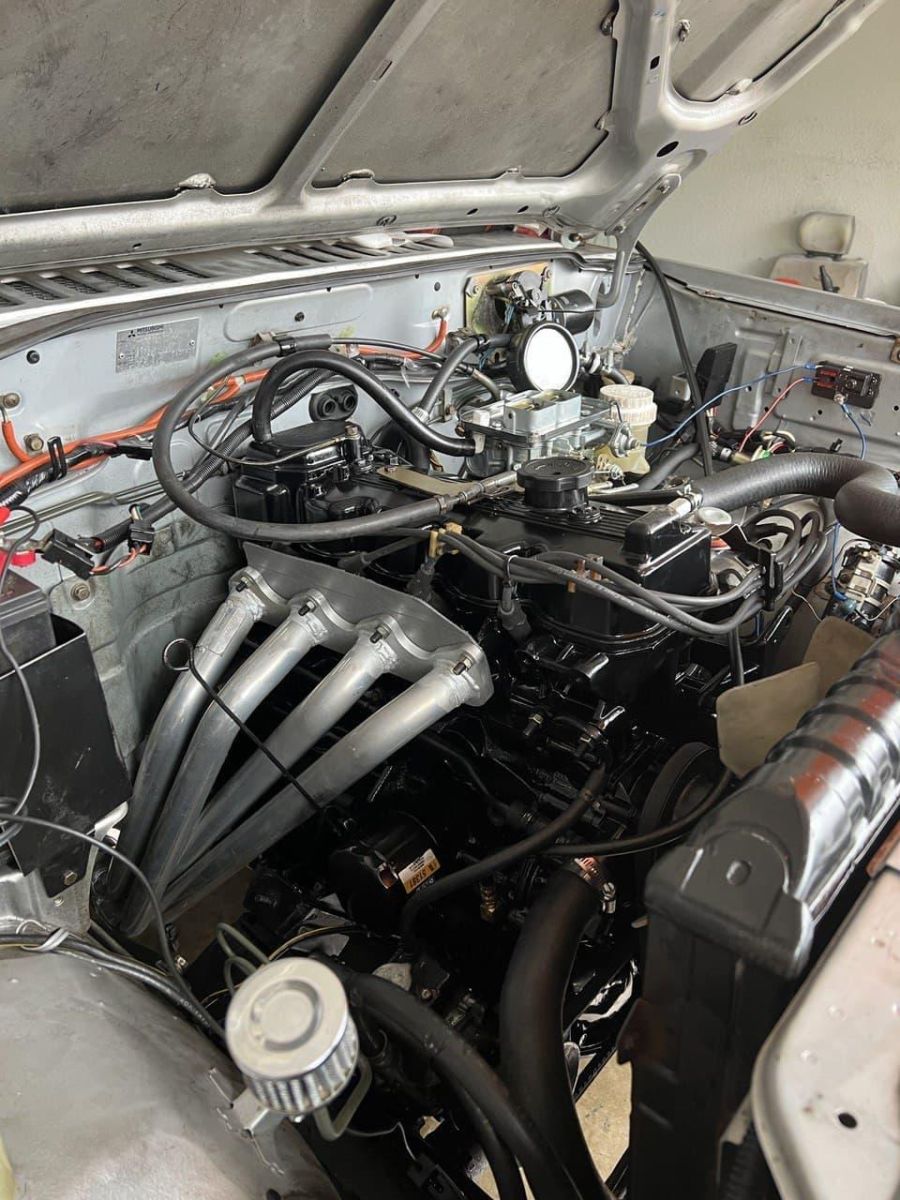

Hello everyone,
I recently dropped a reman motor in my gen 1 and I'm having some trouble getting it set up right. I know the manual says 7 degrees BTDC for basic ignition timing but I am not sure how the vacuum advance figures into that. Right now I have it set at 7 but when I bring in the vacuum advance (I plug it into the manifold) it adds a ton of timing and scares me so I just have it unplugged. This is my first project so all this is very new to me. My questions are:
1. What should the timing be with the vacuum advance
2. What should the timing be without the vacuum advance
3. Where should I connect the vacuum advance hookup (I'm running a Weber 32/36, all emissions stuff has been deleted)
Thank you so much, and I've also attached some pictures of the build.

Set the timing to 7ish with no Vac. I tend to always run more than that but let your engine tell you what it wants once you are driving it.
The factory carb, the Dist vac port is at a position such it does not receive the vac signal till the throttle is opening.
The way this works there is little advance at idle, essentially what the mechanical amount you have set it at.
At a light throttle cruise there is allot of vac to the dizzy offering allot of advance, this is to provide torque and a complete burn cycle for economy.
As you open the throttle more the vacuum diminishes under load, this reduces the advance under high power when the cylinder pressures are high with a dense fuel charge which ignites easier. This reduction in timing reduces the chance for detonation/knock.
With the carb you have, either the throttle plate is open too much at idle or the port is cot controlled by the plate.
Were I would start, connect the vac line, start engine and readjust the idle speed presuming it has increased with the vac advance.
In the past I/we used to need to chamfer or drill the throttle plate to get it where it needs to be for proper control of idle ports etc.
I have no experience with the new China carbs for what they need to run right. I expect these horror stories is simply because carburetor tuning is a lost art.
