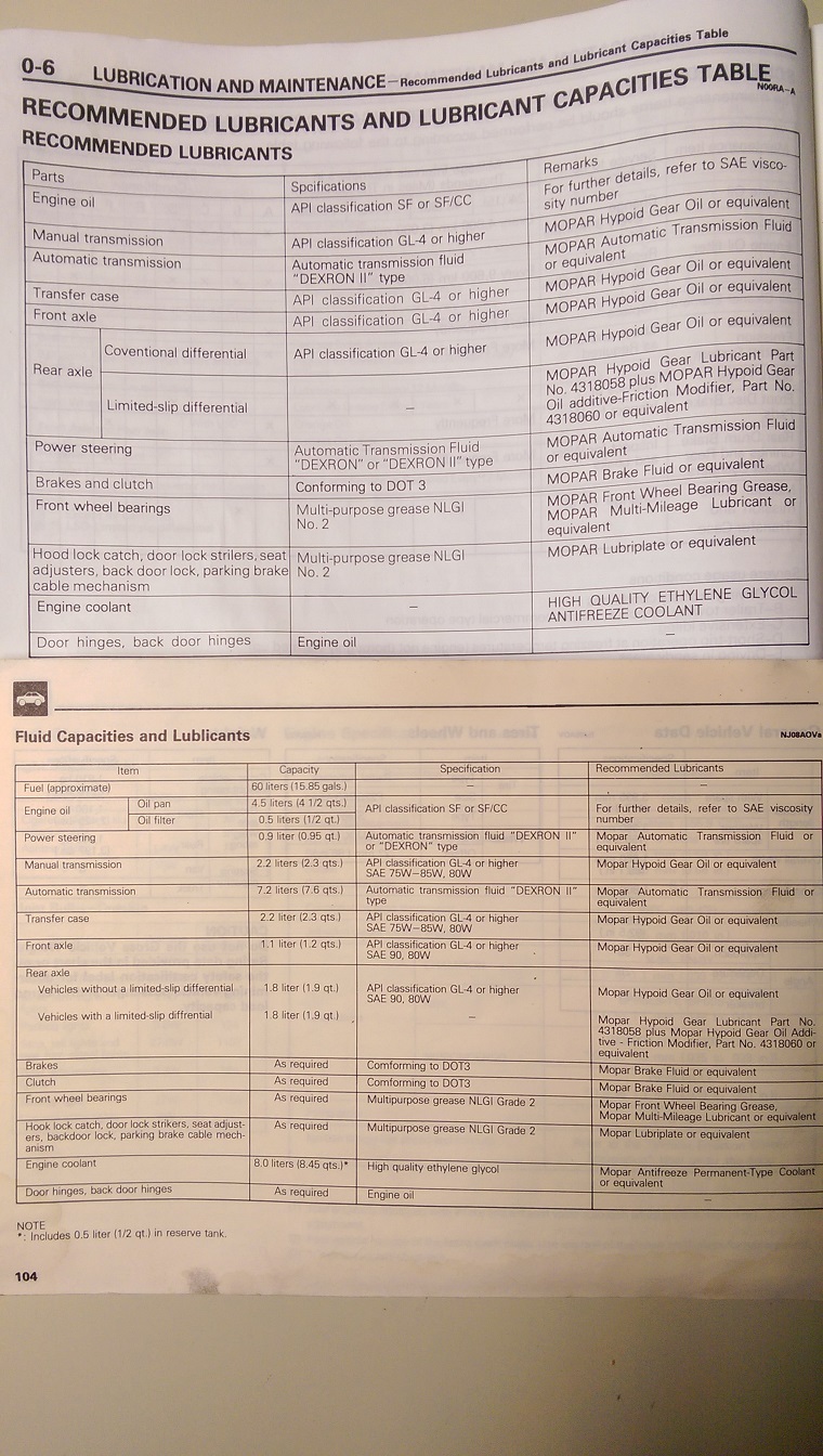

Re: manual transmission lubricant [Re: Anonymous] #1102853 01/25/17 09:28 PM
Joined: Jul 2011
Posts: 26
Maciek Offline
I keep reading the same thing about GL-5 and brass synchros. I'm glad I did some research because both My user manual and factory service manual specify "GL-4 or higher" for all fluids. Guess I'll order a few quarts of MTL or MT-85, or go cheap with a jug of the StaLube 85-90, seems a little thick but reviews are good. The old stuff in there now takes a few mins to warm up when it's freezing anyway (prolly used the same stuff last time, but that was a loong time ago when i first got the truck).
Thanks,
~Mac
