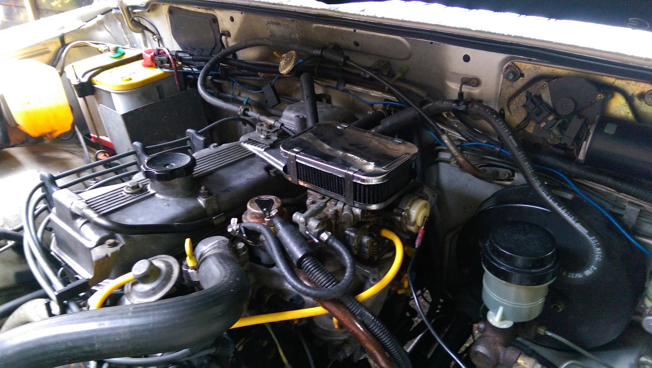

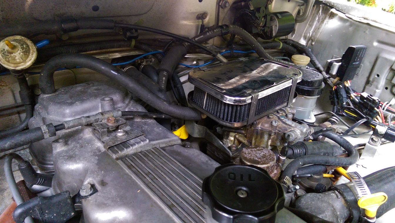

Re: Weber 32/36 DGV vs DFV [Re: DanWheeler] #1102815 01/19/17 09:08 PM
Joined: Jul 2011
Posts: 26
Maciek Offline
Having the same issue. DFEV fit just fine on the 2.6 manual in my raider though, throttle linkage is at the rear where it should be, like on the factory mikuni. Going to have to fab up my own snorkle plenum I guess.
