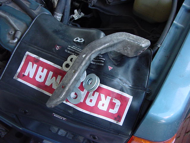

Plus I have an extra bracket, and not quite sure where it goes I have no extra nuts or bolts so it must go somewhere that had an existing bolt, just not sure where, pics comming soon...

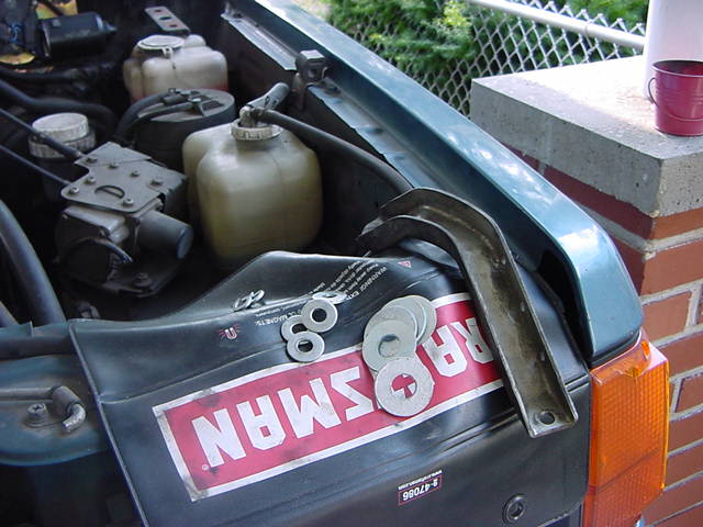

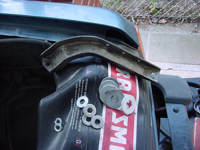

Here is that bracket though plus a few misc photo's:
So what do you guys think that is from or where does it go?? Again I don't have any extra bolts/nuts so whatever it bolted to probably has the bolts/nuts in it already

That's the alternator stay bracket - you can see it in this picture, peeking out from under the intake duct:
Frank
Wow, Frank that is beautiful!! Realy!!! I thought mine look clean, but wow!!!
Thanks for the info on that bracket I will try to see if I can get it to work there...
