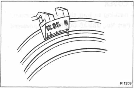

I would still like to know where those damm markings are for timing on the crank pulley.

Look for the notch on the pulley. I'd check the TPS adjustment first, THEN start chasing leaks. Don't go makin' this hard. <img src="/forums/images/graemlins/shame.gif" alt="" />

22R/RE timing marks:

ok so timing mark on pulley at 5 right? and on the 86 with the round terminals... which ones do I short. chilton only shows the later models. please help fast im outside working in the freegin cold
Re: Timing Write Up??? #713122 04/08/06 09:27 PM
ok nevermind, i figured it out from the above link. thanks
