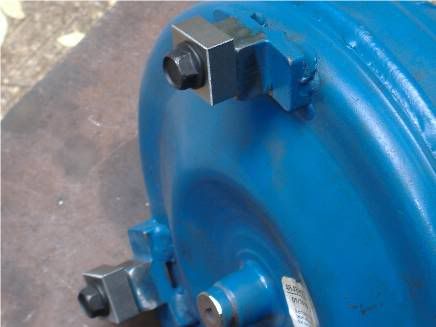

The main modifications were to the torque converter. I got a 2060 stall converter with my rebuilt transmission. I didn't do anything with the stock flex plate, and the stock chevy converter sat farther back in the bellhousing, so I had to add spacers. Bansil made these up for me on short notice <img src="/forums/images/graemlins/kewl.gif" alt="" />
These are 1/2" thick and worked out beautifully. They were the perfect size, but the hole in the feet were not centered, so they didn't line up as nice as I would have liked, but this should provide a nice solid mount.
The spacers allowed the torque converter about 1/16" of movement.
In this picture you can see the snout of the torque converter. I trimmed this down about 1/2", but in hindsight, with the converter spaced back like it was, it might have been unncessary.

ANDRE AND BANSIL WITH THE SPACER IN BETWEEN THE CONV, AND THE FLEX PLATE DOES THE SNOUT ON THE CCONV, GO INTO THE CRANK HUB , IT REALLY NEEDS TO GO IN A BIT TO HELP CENTER THE CONV, AND ALSO HELP SUPPORT IT,, OTHER THAN THAT MAN IT IS LOOKING GOOD JERRY
