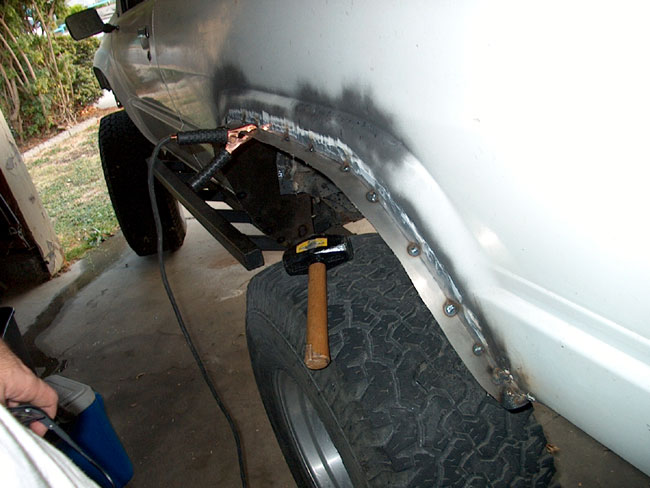

Posts: 1,379
Scerb Offline
<img src="/forums/images/graemlins/wink.gif" alt="" />
Those are Tyler's sh1tty welds btw. My diff <img src="/forums/images/graemlins/cyclops.gif" alt="" />
Re: Toyota truck welding projects [Re: Scerb] #752459 09/19/06 06:15 AM
Posts: 286
jasonmt Offline
Having current pass through roller bearings is generally a BAD thing with a decidedly negative impact on bearing life if the current happens to arc from a roller to race.
Hence the reason you should connect the ground clamp to the carrier rather than the housing in order to prevent this.
