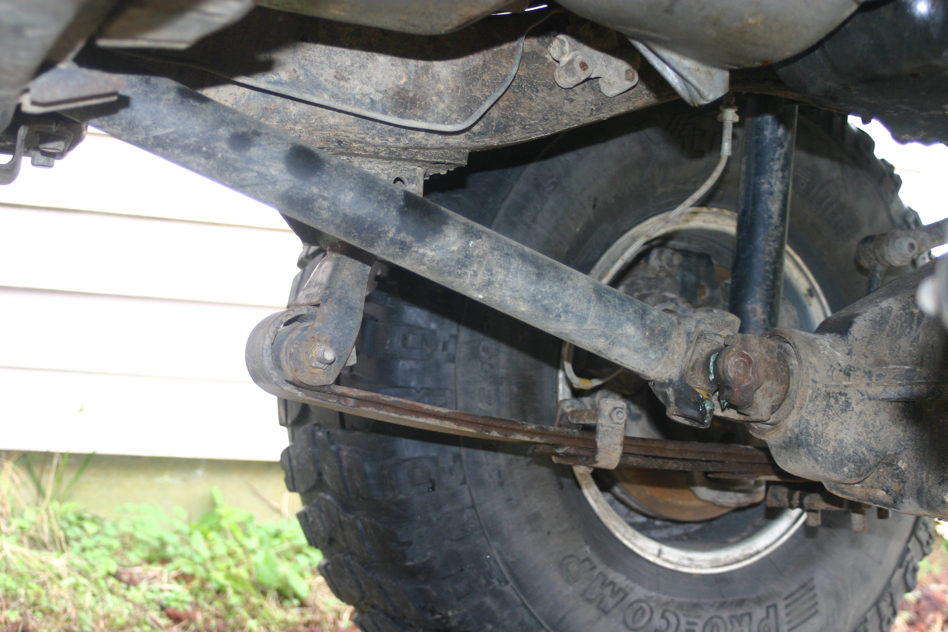

Lift is really not too much of a concern. People think my truck has some MASSIVE ammount of lift, but it really does not. It's got a 2 inch body lift, and however much is built into the SAS. I used stock wagoneer leaf springs when I did my swap at first, and kinds "built" the lift into the mounts.

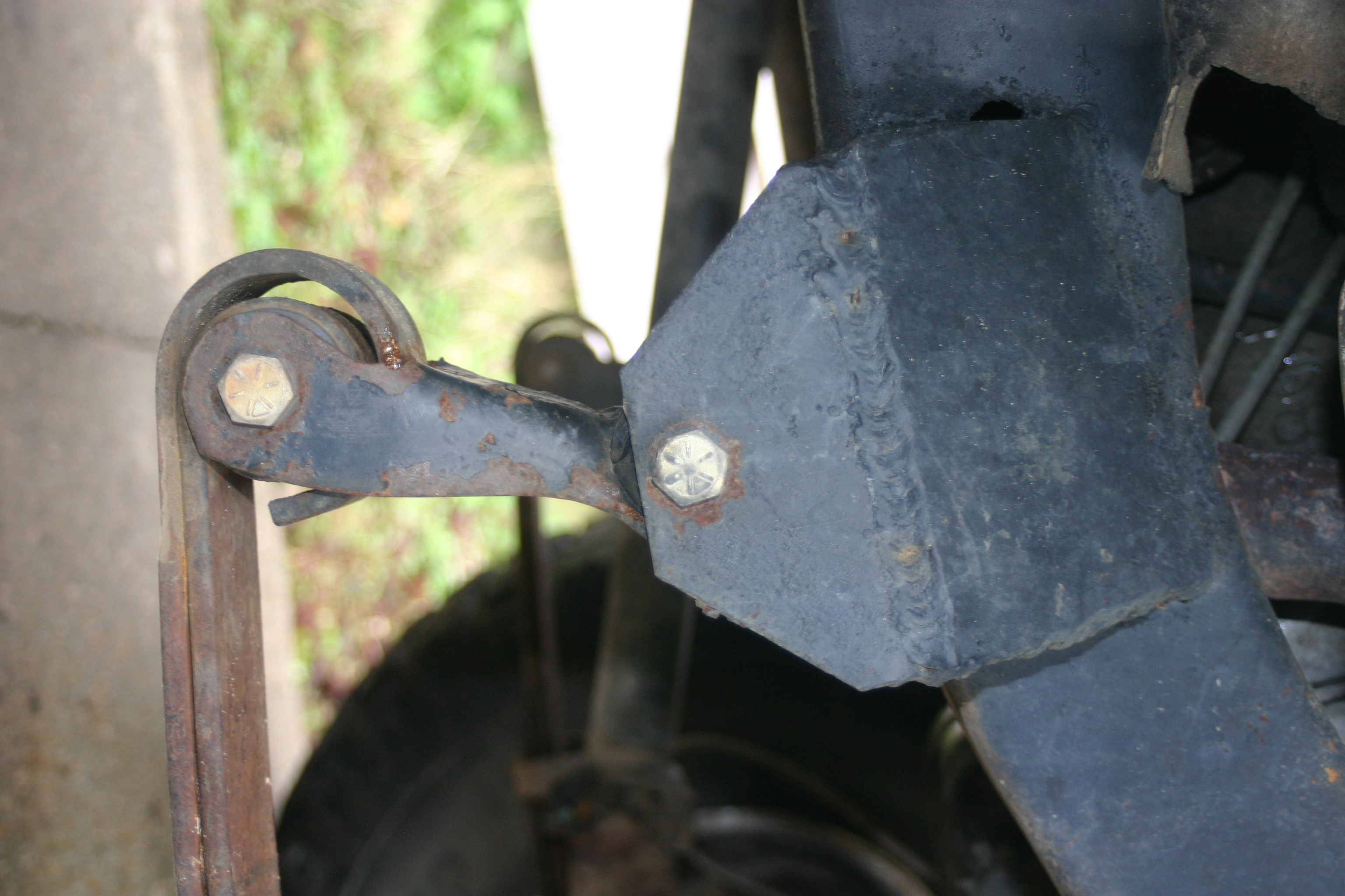

As you can see here, the factory waggy springs were nice and Mushy, but almost flat. The one that is stuffing is actually inverted.
Here it is on flat ground. These are 35's btw.

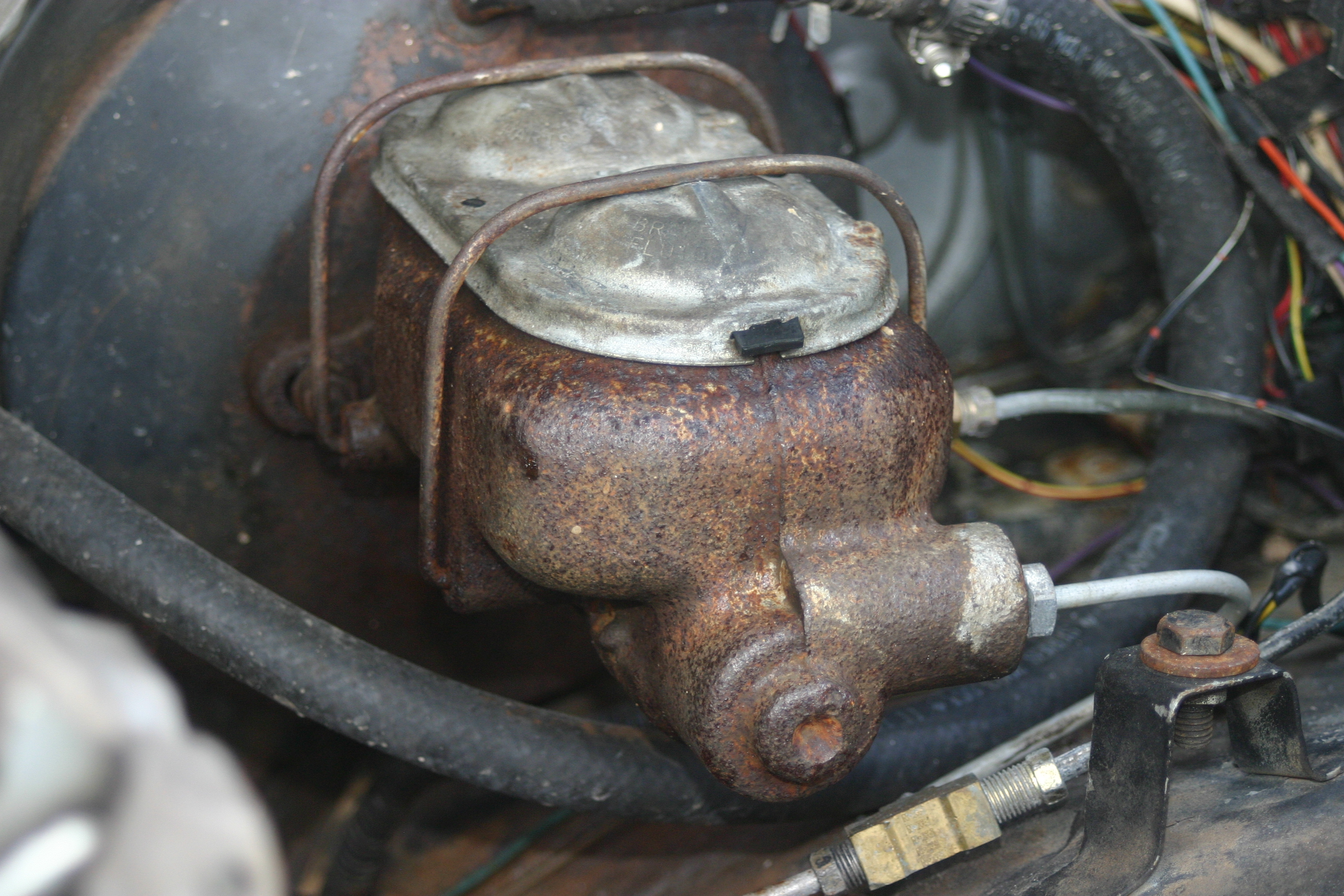

#2 Brakes The D44 uses MUCH MUCH MUCH larger calipers. While you can psychically connect them to a Mitsubishi master cylinder, and it will "work"... it does not work well. What happens is the small master cylinder on the mitsubishi cannot move enough fluid to get the larger calipers to move out of their rest position, and start grabbing on the rotor. IF you pump the brakes really fast, you can get them to move out to the rotor, and it will start to stop the truck. Takes about 3 pumps to get them to start to stop the truck. This is obviously NO good. I ended up using a GM master cylinder. It was ALMOST a bolt in with a little modification to the mounting surface of the new master cylinder. You've obviously got to flare lines to fit other stuff as well.

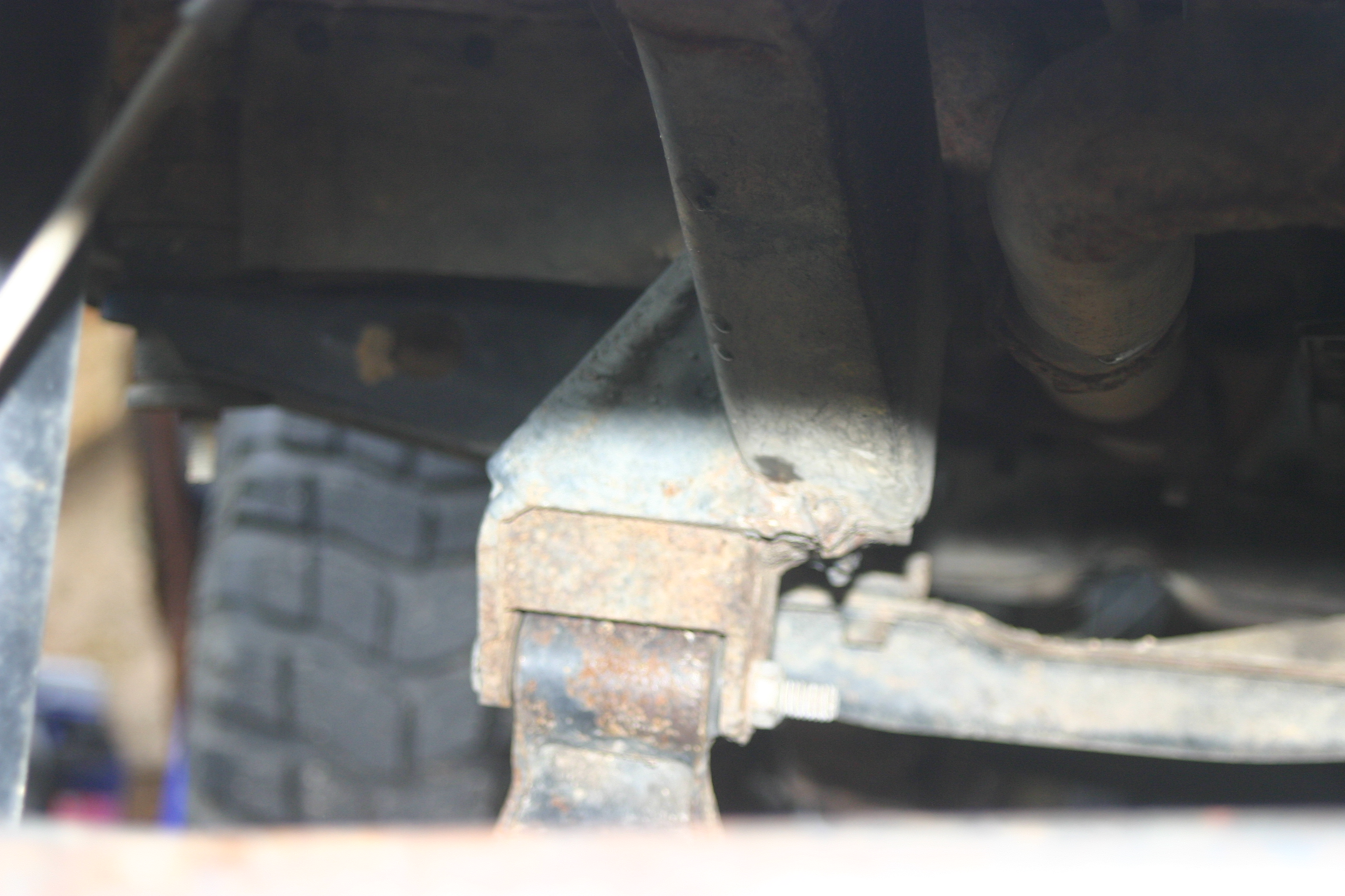

Rear Spring mount. Outboard the frame.

Vette master cylinder
