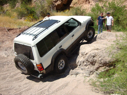

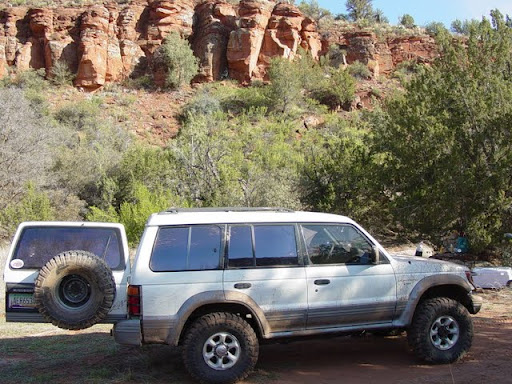

33x12.5/15 on stock 7" wheels, except in picture 2, where the spare is shown on an 8" wheel.
Both pics show the truck with a 2" body lift installed.
