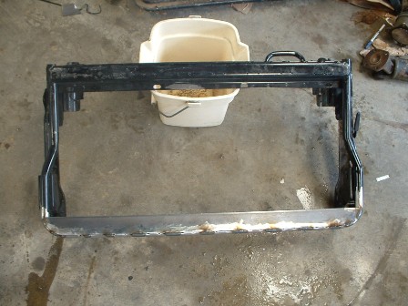

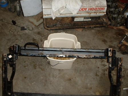

Yes I have 95 jump seats replacing the stock rear bench in my 89 SWB. I think I got the Idea from MontyMcV. I think I have pics in my 89 build thread. CHeck the links in the criticle threads sticky.
*EDIT* pics seem to have dissapeared. I can post new ones if you want or you can look for MontyMcV's write up. But basically you use the frame from the gen one and weld a 2 1/2" piece of flat stock to the front top of the frame. This allows you to bolt the jump seats to the frame. works great.

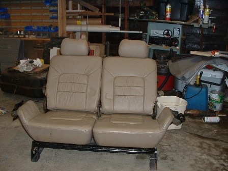

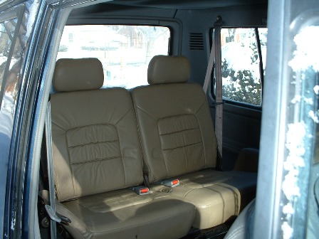

Here's my thread.
The pics are linked via my old domain afabot.com, from before mitsubishilinks.com. The DNS server that points afabot to mitsubishilinks was taken offline (old job I had and they shut down their service). I just got it sorted out with GoDaddy DNS and the pics should come back once the settings propagate. That can take 1-48 hours, depending on where your internet provider gets their info from.
Hmm, the pics will come up in a browser for me from the link, but they are not coming up on The Wire. Looks like the Wire's host still hasn't gotten the new DNS.
Here they are with modified links. They will tumble and fold, as long as the front seats are not slid all the way back.
