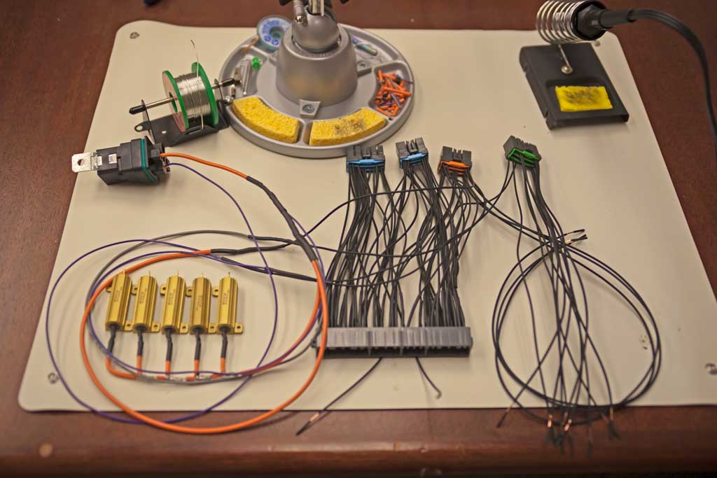

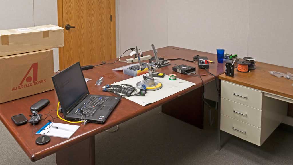

Anyway, got started on the ECM/PCM swap last weekend. Commandeered one of my empty offices and set up shop. <img src="/forums/images/graemlins/smile.gif" alt="" />

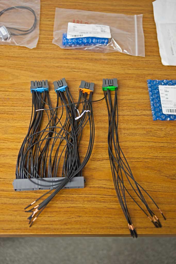

The '97 ECM harness to '99 PCM adapter harness from Boomslang. They're awesome to deal with, BTW. Very nice product, too.
What I have so far. Still have to wire in the A/C and finish the A/T control relay stuff.
I'm a little more than half done. Should be able to test it this weekend on my little '97. Dropped the big one at the shop Tuesday for the frame repairs and to pull the adapter in preparation for the overdue 3-link build so I won't have that back to work with until next month.
