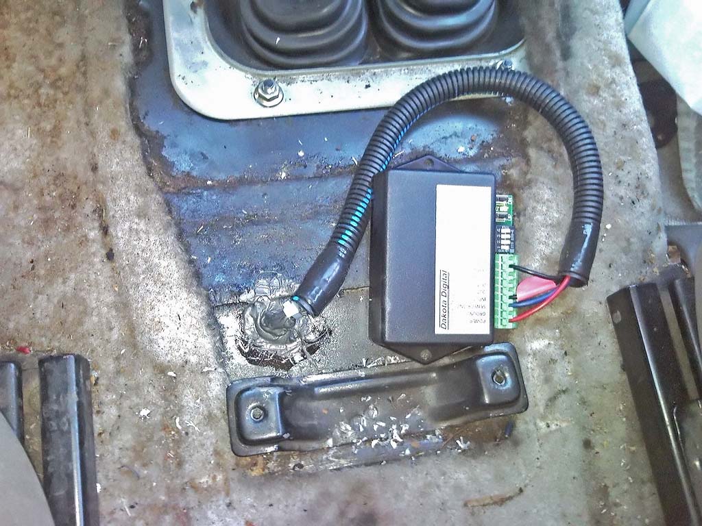

These are the two harnesses I built. The first interfaces the Jeep sensor from the Terra ultra-short SYE kit to the Dakota SGI-5 signal converter. The second is the harness that interfaces the Jeep 4-WD switches with the dash 'in four wheel drive' light. The last is the actual Dakota box in the cab. It sits under my center console.
Anyway, neither of these required too many brain cells. Took me about an hour to do both. I have the wireing harness diagram somewhere, too.
