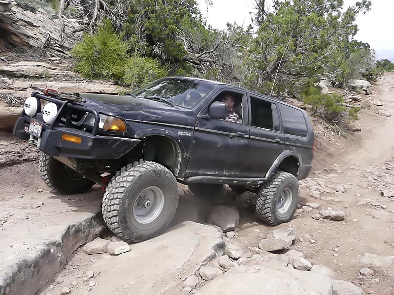

Below is my big '97 Sport with the 6G72 and 530K+ miles on the original engine. This is my DD and it's been 'wheeled hard since I bought it new. Besides wheeling in CO it makes 2-4 trips a year to Moab - 2 or 3 trips usually are in the dead of summer when the temps are pushing 100-105 loaded with gear and passengers. Normally it weighs in at 5500 but on vacation weighs in at 6500-6900 lbs. It gets driven over two 11,000 foot mountain passes, and we do 70-75 Mph out and back. Not easy with a vehicle that weighs that much with an engine that small. <img src="/forums/images/graemlins/smile.gif" alt="" /> I've always run a K&N FIPK (GT3000) open element air filter - which a lot of people don't like 'cause they claim it lets in too much dirt.
All I do is the owners manual proscribed maintenance. The only thing I do differently, is I run Mobil 1 full synthetic 10-30/10-40 and I change it every 9,000-10,000 miles. An engine design with issues or poor production quality would never stand up to that kind of abuse.
It still didn't smoke under any condition two months ago even with a dead cylinder and I was putting in a quart of oil a month.
