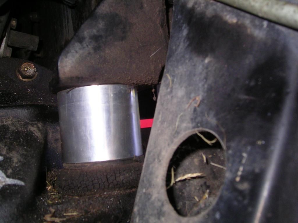

Front diff drop fitted.
Front diff drop 2
Front diff drop 3

The diff drop has definately worked on the CV angles bringing them back to an aceptable angle. <img src="/forums/images/graemlins/scared.gif" alt="" /> I am a bit worried about the front diff drop moving when the front hits something hard and will talk to Runt313 about his setup. <img src="/forums/images/graemlins/wink.gif" alt="" />

Re: Suspension been fitted [Re: 4runnernomore] #1058039 04/21/13 11:14 PM
Joined: Apr 2011
Posts: 326
Peabody Offline
Ah!!! Now I see why the diff-drop kit you used didn't make sense to me. The front axle housing's end-cap hanger is different on your Aussie model. Here's what they shipped on the U.S. version...
