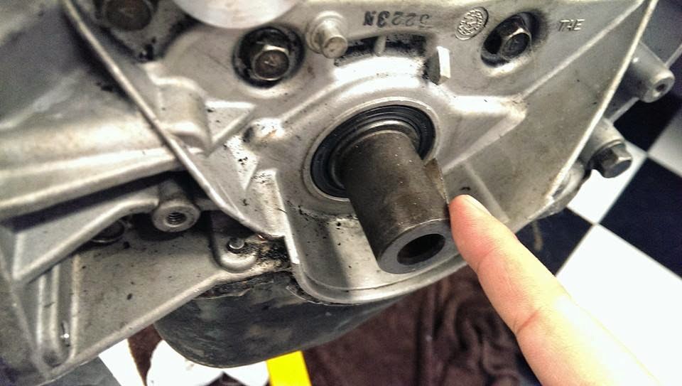

I know that what I'm about to show you is different than what you have but check this out. I just found a picture of my bolt length in the 3.0L crankshaft. I would expect to get about the same on your bolt and 3.5L crankshaft. It didn't bottom out even with the Harmonic Balancer off the crank shaft. The only thing I had on there was that new concave washer. That was what was stopping the bolt from going any further into the crank.

Perhaps you may find these photos useful. They are from my old 1997 Montero SR 3.5L. I replaced the HB and the washer and bolt.

I've got a lot of pictures from my 3.0L overhaul, but sadly I didn't document the 3.5L the way I normally like to because it was my wife overhauling and I was helping. It threw me off from my normal game. So no problem on the photos, I just wish I had the same amount I normally take for the 3.5L. Dang I missed my chance.
